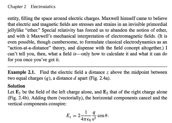

When there is electric charge, then there is an electric field in space aorund it. Or when the electric charge is moving (without acceleration), then it is produced magnetic field in a space around it. Both of these fields permeated to infinity according to Maxwell theory. But how fast electromagnetic field permeated? Is that faster than electromagnetic waves produced by accelerating charge? How possible electromagentic waves with speed c traveling without there is electromagnetic field in the first place (as per definition)?
An electromagnetic wave is an electromagnetic field that varies in time and space in such a way that it satisfies the wave equation. We can't have an electromagnetic wave if we don't have electromagnetic field!
