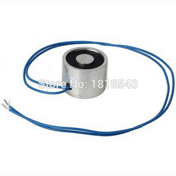

Normally a lifting magnet is made with the geometry show in the picture below.
The center is one magnetic pole, the outer, silvery ring is the opposite pole, and in between are the windings.
You want a flat surface on the top of the hammer to most efficiently close the magnetic circuit, and gain the greatest lifting force for a given magnet size.
Some lifting magnets are permanent/electromagnets. This means that there is a permanent magnet to do the lifting. To drop the hammer, a pulse of current is delivered through the coil that cancels the field generated by the electromagnet to release the hammer.
Is the hammer made of steel? Do you have access to machinery to fabricate something similar to the above picture?
