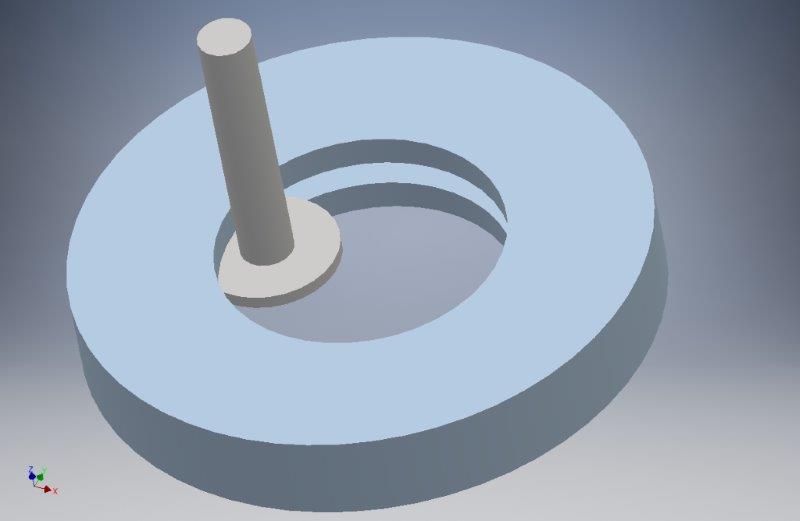

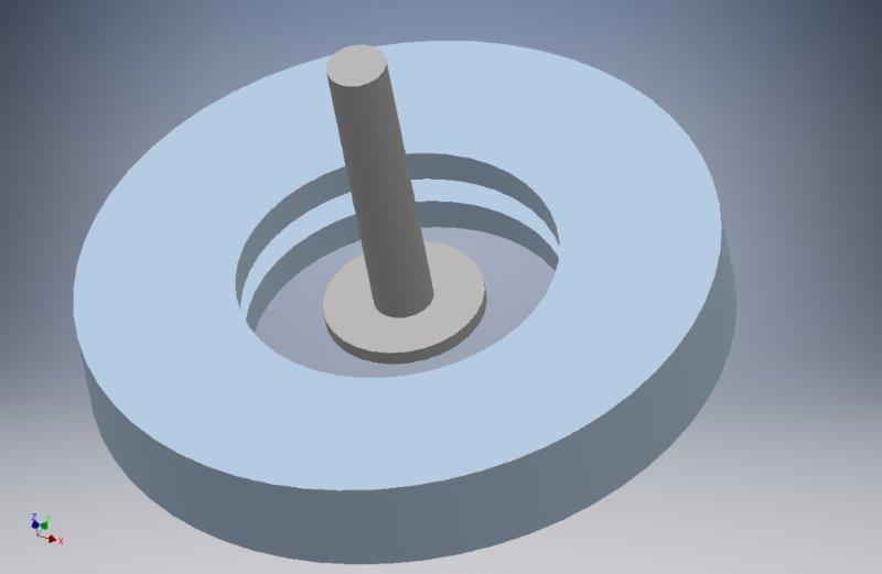

I have an electromagnet device that I am designing and need a bit of help from some of the brilliant people on this site. Here's the problem:
I have a disk attached to the end of a shaft and the shaft/disk assembly can move radially (via a spring loaded mechanism). This shaft/disk fits within the inside diameter of a donut shaped electromagnet consisting of a coil surrounded by an iron armature. The electromagnet is stationary.

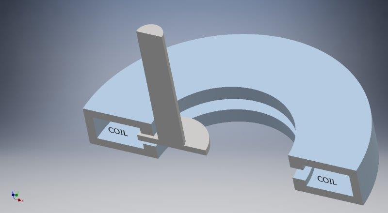

When the shaft moves radially over to the side of the ID of the magnet, the magnet is then energized to temporarily to hold the shaft/disk against the ID (the magnet does not cause the movement). After a set amount of time the magnet is de-energized releasing the shaft/disk which returns back to center. The radial movement can happen in any direction (0 to 360°) and

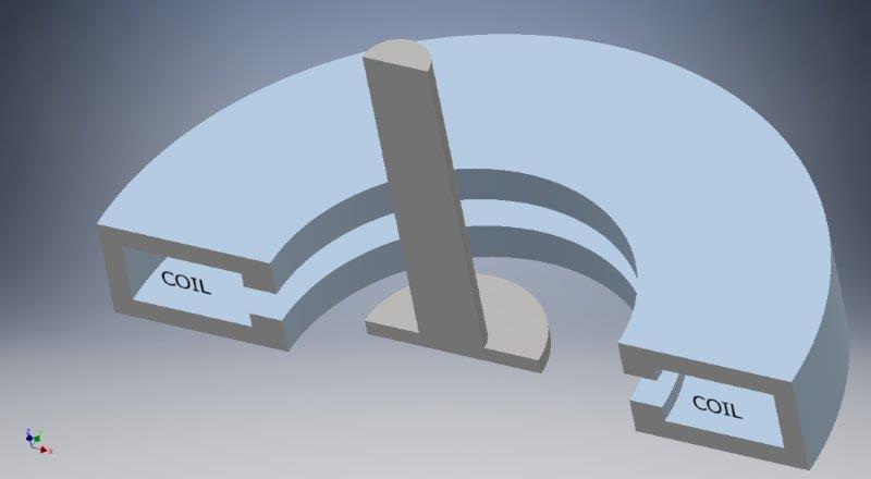

Here's a sectional image:
Here's very preliminary data just to get an idea of sizes: Magnet Iron Armature OD = 10" ID=5". Disk OD= 4", Shaft=1.5", and a force of around approx 8 lbs.
So here are my questions:
1) I've been looking but have not been able to find any physics papers on this type of magnet. I'm trying to find formulas and some theory for optimum dimensions, coil sizes, wire sizes etc. (it's been 40 years since I had this type of physics in college...ugh) Any links that you can provide would be great!
2) What is the best orientation of the coil's winding to create a radial force?

What DC voltage and current is available to drive the coil. How long in seconds does the field have to latch on, and to release the disk.
What do you mean by “magnet iron”? You must use something like common mild steel if you want the field to turn off. You may need to use a special circuit to turn the field off quickly and then stop with very low or zero magnetic field.
Have you considered using a permanent magnet for the disk. That way, momentarily reversing the electromagnet field might repel the disk from the gap. What will stop the disk swinging like a pendulum?
Why reinvent the wheel? What is the purpose of this device?

I guess you could make the donut as two circular halves. Glue a wrapped circular coil into one half before putting the other half on as a lid.
Yes, the donut steel or iron armature would have to be in two circular halves (that would be the only way to machine it) and the coil would be wound onto a separate round donut which would be glued into the half and then the two halves bolted together.
The problem I'm having is that the field inside a coil is easily predicted and I can calculate that, but in this application I need the concentrated field to to be in the plane of the donut. It seems i can't use the right-hand rule because of cancelling fields? I am unsure as to what the best configuration of the coil would be to achieve this effect. In order to orient the fields, should there be two coils sitting on top of each other, or side-by-side? Or just a single coil? Should the coil(s) be wound around a nonferrous core...such as a plastic donut? .
I was hoping there would be some published data, or someone can provide technical guidelines for this type of electromagnet in order to be able to create the most efficient configuration.

The position locking effect is not likely to be stable . Magnetic force might hold armature off centre but there is no component of that force preventing the armature from orbiting around .
I agree with @Baluncore that there must be better ways of doing this .
I understand about the instability and that's okay. I found something that is very very close in principal to what I need. It is the type of magnet used to keep Foucault Pendulum displays moving. It consists of a disk attached to the cable (near the cable's attachment at top), and a stationary ring magnet surrounding the cable/disk which is energized when the pendulum nears the apex of each swing. This pulls the disk into the magnet with enough force to overcome air friction and gravity to keep the pendulum moving.

You confirmed what I already knew about designing a coil, however my questions are regarding how to design the outer iron 'shield', in conjunction with the coil, to optimize the magnetic field strength in the plane of the slot of the shield, thereby maximizing the resulting radial force on the armature (disk). When I started this project, my thinking was that an iron shield surrounding the coil with a single open slot around the ID, would 'redirect' and focus the field radially within the slot of the iron. This is the same methodology used with the University of Louisville's Foucault pendulum magnet, so I believe I'm on the right track with the shape of the iron.
I've also been trying to determine if a toroidal type of coil would be better than one wound into the diameter of the coil chamber in the iron (as the one you detailed). Intuitively this doesn't seem to work, but I did see a toroidal electromagnet on a site that was used as an magnetic bearing for an axle. I know that with a toroidal coil, the maximum field strength is within the coil, whereas a coil wound to the diameter of the chamber, the maximum field strength would be somewhere around the center of the coil which is the center of the iron ID. Of course without the iron, this field would be normal to the plane of the slot which is 90° to the direction of field/force that I need. I've looked up methods to calculate fields outside a coil (Biot -Savart for one), but I have been unable to find analysis methods for approximating shielding to redirect fields . I know it can be modeled in magnetostatics software, but is there a simple way to approximate it?

Design of the magnetic circuit is difficult because the disk only intrudes into part of the internal anular gap. So just make sure that the magnetic path has the same minimum wall thickness as the pole area, and is no where excessively thick which would slow down the magnetic transition. Like in your drawing, but replace the sharp corners with radius bends.
As I wrote earlier, your design is not yet optimum, you will have to stop procrastinating and build the prototype. If it fails, modify it to make it work. If it works, expect to replace it with an engineered solution later, optimised for the quantity that will be built.
