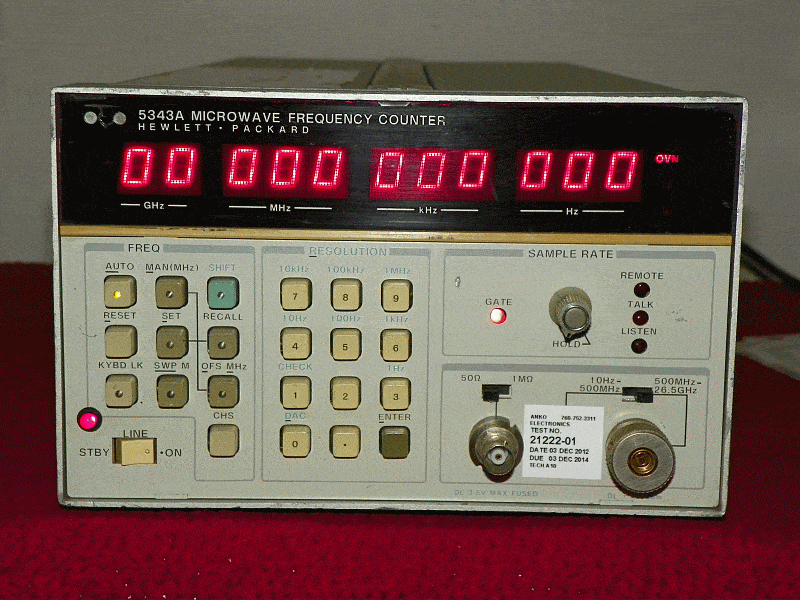

they (RF signals) are measured using frequency counters
My trusty ol' HP5343A that I have at home goes from 10 Hz up to 26GHz
its one of my treasured bits of test gear
Dave
