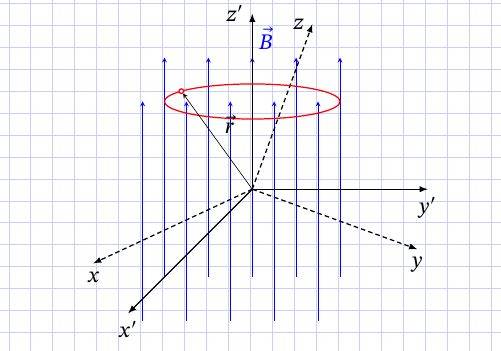

Hi all, I interested in how can I get low of motion in for orbiting particle in a uniform magnetic field
$$\frac{d\vec{r}}{dt} = \vec{\omega}\times\vec{r},\qquad
\vec{\omega} = \frac{e\vec{B}}{mc},$$
Of course, rotating about z' axis is very simple.
\begin{equation}\label{eq:K}
\begin{cases}
x' = R\cos(\omega_{z'} t ), \\
y' = R\sin(\omega_{z'} t ), \\
z' = z'_0.
\end{cases}
\end{equation}
But what can I do, when axes is arbitrary oriented?
If you already solved for the trajectory in terms of one set of coordinates, finding the trajectory in another rotated set of coordinates is just a case of representing the position vector with respect to a new basis. I.e. if the rotation matrix that takes your old basis ##\boldsymbol{e}_i## to your new basis ##\bar{\boldsymbol{e}}_i## has components ##R_{ij}##, e.g.$$\bar{\boldsymbol{e}}_i = R_{ij}\boldsymbol{e}_j$$And the position vector has representations in both bases$$\boldsymbol{r} = r_i \boldsymbol{e}_i = \bar{r}_j \bar{\boldsymbol{e}}_j = \bar{r}_j R_{jk} \boldsymbol{e}_k$$Take inner product of both sides with ##\boldsymbol{e}_l##,$$r_l = R_{jl} \bar{r}_j \iff \bar{r}_j = (R^{-1})_{jl} r_l$$In other words, the column matrix of components transforms by applying the inverse of the matrix you used to rotate the coordinate system.
Yes, but then the equations get more complicated and look something like this:
\begin{align*}\label{}
x(t) &= x'(t)\cdot(\ldots) + y'(t)\cdot(\ldots) + z'(t)\cdot(\ldots) ,\\
y(t) &= \ldots ,\\
z(t) &= \ldots
\end{align*}

Sure, but isn't that what you wanted? Of course the equations of motion aren't going to look very nice if the coordinate system you are using isn't very nice

Any coordinate system is well adapted for describing some kinds of motion (in particular, those lying in its surfaces of constant coordinate), and any other motion is not so efficiently described. You are switching from a system that allows you todescribe your particular motion very efficiently into one that is much messier.

Before starting this dreary journey, I wonder if it will be possible to express them like this:
x &= \mathrm{const}(\underbrace{\psi, \theta, \phi}_\text{some angles between coord systems}) f(\omega_x t),\\
y &= \mathrm{const}(\underbrace{\psi, \theta, \phi}_\text{some angles between coord systems}) f(\omega_y t) ,\\
z &= \mathrm{const}(\underbrace{\psi, \theta, \phi}_\text{some angles between coord systems}) f(\omega_z t)
\end{align*}
Might I ask, what's the desired end-result here? You're probably making life more difficult than it needs to be!
The end-result here is write down the equations of motion in arbitrary coordinates through the coordinates of the angular velocity [itex]\omega_x[/itex], [itex]\omega_y[/itex] and [itex]\omega_z[/itex].
After I see these equations, I want to solve this problem by methods of Lie group theory ($SO(3)$, generators, matrix exponent). As I did, it will be easier for me to understand the group-theoretical approach itself.
In that case just apply the rotation matrix I defined in the post #2. If you really want, you can write the matrix in terms of the Euler angles, but that seems a bit unnecessary.
Remember that when you rotate your coordinate system the components of the angular velocity will also change, since ##\boldsymbol{\omega} = \omega \boldsymbol{e}_{z'}## and you must describe ##\boldsymbol{e}_{z'}## in terms of the new basis vectors in order to determine the new components. You can do this with the same matrix that you used to transform the position vector components.

I'm only a bit puzzled by the equation in #1. The equation of motion for a particle in a uniform magnetic field (in non-relativistic approximation) reads
$$m \dot{\vec{v}}=q \vec{v} \times \vec{B}$$
or
$$\dot{\vec{v}}=-\vec{\omega} \times \vec{v}, \quad \vec{\omega}=\frac{q}{m} \vec{B}.$$
To solve it, it's convenient to choose your arbitrary coordinates in a convenient way. So use a Cartesian right-handed basis such that ##\vec{\omega}=\omega \vec{e}_3##. Then
$$\dot{\vec{v}}=-\omega \vec{e}_3 \times \vec{v}=-\omega \begin{pmatrix}-v_2 \\ v_1 \\0 \end{pmatrix}.$$
For the 3-component you find
$$v_3=v_{30}=\text{const}.$$
The other two equations are most easily solved by writing
$$\xi=v_1+\mathrm{i} v_2.$$
Take the time derviative
$$\dot{\xi}=\omega (v_2-\mathrm{i} v_1)=-\mathrm{i} \omega \xi \; \Rightarrow \; \xi(t)=\xi_0 \exp(-\mathrm{i} \omega t)=(v_{10}+\mathrm{i} v_{20})[\cos(\omega t)-\mathrm{i} \sin(\omega t).$$
Taking the real and imaginary part gives
$$v_1(t)=v_{10} \cos(\omega t) + v_{20} \sin(\omega t), \quad v_2(t)=v_{20} \cos(\omega t) - v_{10} \sin(\omega t).$$
This you can write in a matrix-vector form
$$\vec{v}(t)=\begin{pmatrix} \cos(\omega t) & \sin(\omega t) & 0\\ -\sin(\omega t) & \cos(\omega t) & 0 \\ 0 & 0 & 1 \end{pmatrix} \vec{v}_0.$$
This is a rotation around the direction ##\vec{n}=\vec{\omega}/\omega## in the negative direction (i.e., with ##\vec{n}## pointing towards you in clockwise direction around this axis).
You can write this in a coordinate-free way,
$$\vec{v}(t)=\vec{n}(\vec{n} \cdot \vec{v}_0) -\sin(\omega t) \vec{n} \times \vec{v}_0 + \cos(\omega t) \vec{n} \times (\vec{n} \times \vec{v}_0).$$
To get the trajectory, just integrate it once more over ##t## from ##0## to ##t##:
$$\vec{x}(t)=\vec{x}_0 + \vec{n}(\vec{n} \cdot \vec{v}_0) t + \frac{\cos(\omega t)-1}{\omega} \vec{n} \times \vec{v}_0+ \frac{q}{\omega} \sin(\omega t) \vec{n} \times (\vec{n} \times \vec{v}_0).$$
