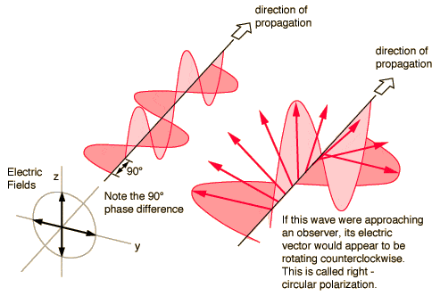

Concept check:
A Right hand circular polarized wave is having the E vector circulates in the direction of the fingers with the thumb in the direction of wave propagation with its components Ey leading Ex by 90 degrees?
Yep
Diagram of right-circular polarization: two sinusoidal electric field components along the z and y axes, 90 degrees out of phase, travelling along a direction of propagation arrow; a helix of electric vectors shown rotating counterclockwise as the wave approaches an observer.
http://hyperphysics.phy-astr.gsu.edu/hbase/phyopt/polclas.html#c3"
  • Diagram of right-circular polarization: two sinusoidal electric field components along the z and y axes, 90 degrees out of phase, propagating along a diagonal axis labelled direction of propagation; the rotating electric vector appears counterclockwise to an observer approaching the wave.
