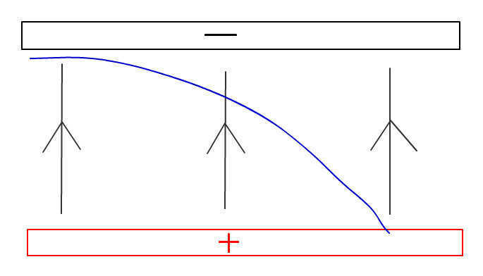

An electron is fired at 4.0 x 10^6 m/s horizontally between the parallel plates, as shown, starting at the negative plate. The electron deflects downwards and strikes the bottom plate. The magnitude of the electric field between the plates is 4.0 x 10^2 N/C. The separation of the plates is 2.0 cm.
A) Find the acceleration of the electron between the plates.
B) Find the horizontal distance traveled by the electron when it hits the plate.
C) Find the velocity of the electron as it strikes the plate.

Diagram of an electron deflecting between parallel plates: a negative plate labeled minus at top, a positive plate labeled plus at bottom, and a curved blue path from the top plate down to the bottom plate, with three stick figures standing between the plates.
m a = ε q
Δdy = v1y Δt + 1/2 a Δt2
Δdx = v1x Δt
v2x = √ v1x + 2a Δdy
A)
m a = ε q
a = ε q / m
a = (1.6 x 10-19) (4.0 x 102 / 9.11 x 10-31
a = 7.03 m/s2 [down]
B)
0.2 = 0 Δt + 1/2 (7.03 x 1013)
Δt = (0.02) (2) / (7.03 x 1013)
Δt = 2.3 x 10-8
Δdx = v1 Δt
Δdx = (4.0 x 106) (2.3 x 10-8)
Δdx = 0.092 m
Δdx = 9.2 cm
C)
v2x = √ v1 + 2a Δdy
v2 = (4.0 x 106) + 2 (7.03 x 1013) (0.02)
v2 = 4.34 x 106 m/s2 [down]

There are some typing errors in your work, but the method and the results are correct. The vertical velocity component could have been easier to get from v=vo+aΔt. You knew the time and that vo=0.
And the field is electric, not magnetic as you wrote in the title.
You did quite well|: work with symbols, find right values, etc.
The working with symbols could be kept up a little longer: my Δdx = 9.5 cm because Δt = 2.38 10-8 s. You should continue to calculate with the correct value but for results you report a reasonably rounded value (2.4 in this case)
You do want to check more thoroughly afterwards: the 1013 you found and used in b is missing in a.
The 0.2 in b should be 0.02 (2 cm)
and the first term in the sqrt in c misses a square.
the last answer doesn't have the dimension of a velocity.
The numerical value of the answer is correct though, so you must have done the right thing.
One extra: velocity is a vector. You state 4.34 106 [down].
Bad-mood markers jump on that. Either 4.34 106 [##\theta = -.397##], or (vx, vy) = (4, -1.68) 106 m/s
