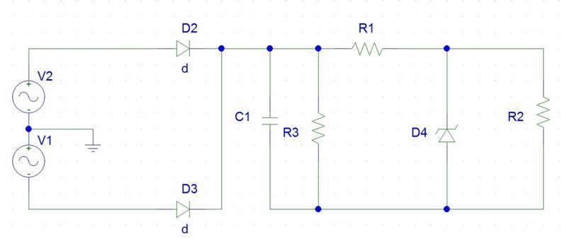

Design a rectifier with a zener diode that satisfies the following:
Primary voltage = 120V @ 60Hz
VDC = 12V
IR2 = 100 mA (R2 being the load)
Vr(R2) <= .3V
C=IDC/(2fVr)
IDC=IR3 + IR1
I tried calculating the capacitor, but how am I supposed to get IDC if I don't have any other current?
