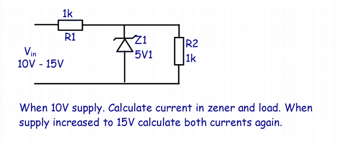

So basically, as the question says, you need to calculate the current in the zener and load when the supply voltage is 10V and then again when it's 15V.
FOR 10V SUPPLY
Voltage across resistor = 10-5 = 5v
Supply current = 5/1000 = 5mA
Voltage across load = 5V as Zener and load are in parallel
Current through load = 5/1000 = 5mA
Current through Zener = Supply current – Load current = 5 – 5 = 0
FOR 15V SUPPLY
Voltage across resistor = 15-5 = 10v
Supply current = 10/1000 = 10mA
Current through Zener = Supply current – Load current = 10 – 5 = 5 mA
This doesn't look correct. I've never did a question with zener diodes before and I'm confused. What is it I'm doing wrong?

Your calculations are fine as far as they go, however...
The designation "5V1" on the zener diode is a fairly common way to specify the zener voltage where the "V" is placed to represent the decimal point. I don't know if this syntax was explained to you. So the zener in question has a 5.1 V threshold.
This will affect your calculations. In particular, if there's not enough voltage "left" after the drop across R1 to let the zener operate then the zener can't conduct any current; it's as if the zener is removed from the circuit. I suggest that the first thing to check is whether or not a zener in that location will be able to conduct: remove the zener and check the potential at that node. If it's less than the zener voltage then the zener will have no effect on the circuit. If it's higher than the zener voltage, then the zener can conduct and "pull" the voltage down to its threshold voltage of 5.1 V.

The zener voltage is 5.1 V. Use 5.1 V. And do the check I suggested for each of your power supply voltage cases.

Current through Zener = Supply current – Load current = 9.9 – 5.1 = 4.8 mASo for the current through the zener for the 10V supply, it's -0.2mA? I don't understand. Is that correct?
This means the zener is not working and has no effect on the circuit. You should analyse the circuit by removing the zener. It is not conducting any current.

The calculation is fine mathematically, but it doesn't apply to the circuit you're analyzing. You're making an assumption about the potential at the top of the zener which is not true for this case.
Okay, so let's say I get that question in my test and I do the calculations that I have just shown using 5.1V as the zener voltage. Will I get the marks for that?
No. At best you'll get partial marks. You failed to recognize that the zener was not going to conduct at all because it was being "asked" to operate outside of its range of operation for zener mode.
Always check whether or not the zener is going to be able to conduct in a given situation. If it cannot conduct then it won't behave as a zener; it'll just behave as an open circuit.

You stated two incorrect values. No points for that.
You made an incorrect assumption, that the zener would hold its voltage at 5.1 V. With the given circuit and a 10 V supply the zener could not do that (which is why you want to do the check first). So the load current and the source current, both calculated assuming that the zener would be at 5.1 V, ended up with incorrect values.

Okay, so before doing any calculations I check if it will work and if not, I state that it won't conduct. What about the values that "I need to state explicitly?" What are the values I need to state to get all the marks?
You need to state that the zener current is zero and the actual load current (by a new calculation).

No. How did you determine the supply current?
Oh, yea, sorry.
Voltage across resistor = 10V
Load current = Supply current - Zener current = 10 - 0 = 10mA

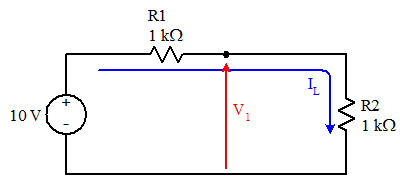

No, 10 V is not across R1. Re-draw the circuit with the zener removed. What's left?
There's only 2 1k resistors left in series. 5V is split between both of them.
Total resistance = 2k
Supply current = V/R = 10/2000 = 5mA
Load current = 5mA
Load current = 5mA
Yes! :smile:
