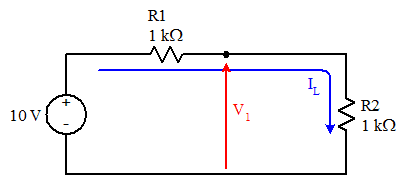

The voltage is 5V.gneill said:If your load current is 5 mA, what is the voltage V1 in the following diagram?
View attachment 108524Yes.
And just quickly about that second circuit, just so I know this is correct. The reading on the voltmeter would be 9.1V and the reading on the ammeter would be:
Voltage across resistor = 20 - 9.1 = 10.9V
Reading on ammeter = 10.9/10000 = 1.09mA
Mentor
- 20,989
- 2,934
Correct. Which is less that the zener voltage of 5.1 V. So the zener placed there would not conduct. That's the test I was urging you to carry out.nothing909 said:The voltage is 5V.
Yes, that looks good.And just quickly about that second circuit, just so I know this is correct. The reading on the voltmeter would be 9.1V and the reading on the ammeter would be:
nothing909
- 168
- 4
okay, great, thanks very much for all your help. :)gneill said:Correct. Which is less that the zener voltage of 5.1 V. So the zener placed there would not conduct. That's the test I was urging you to carry out.
