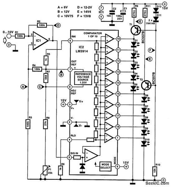

Notice the similarity between your circuit and this one, which shows the insides of a LM3914 chip.
This chip drives up to 10 LEDs depending on the input voltage, but it works the same way as your circuit.
