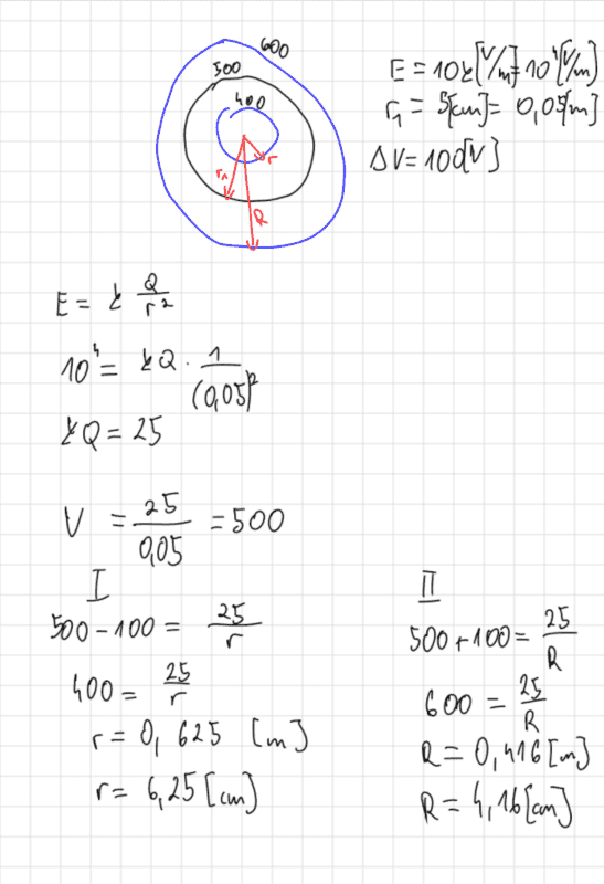

The equipotential surface passes through a point with field intensity electric 10 kV / m at a distance from a point charge generating a field of
r1 = 5 cm. At what distance from the field generating charge it belongs
carry out the second equipotential surface to make the potential difference
between these surfaces was equal to 100 V.
E=V/d
Could somebody check my solution? I want to know is it correct.

I think this is a badly worded question. There can be a potential difference between two surfaces that is positive or negative which this problem doesn't specify. That will dictate whether the second surface is closer or further away from the point charge than the first surface. Basically what I'm saying is that without further specification of higher or lower potential we have two possible answers for how far away from the point charge (the one generating the field) the second surface is located.
I will try this problem out for myself and see what I get in about an hour or so using both higher and lower potential (assuming I understand what the problem is saying).

I'm getting the same answers you are getting using your approach; ##6 \text{ cm}## if we're at a lower potential and ##4 \text{ cm}## if we're at a higher potential. But I think your approach is extremely crude but it may work for introductory physics classes. For higher level classes you have to keep in mind that ##\vec{E}## is not constant from equipotential surface to another it actually changes
##E = -\frac{\Delta V}{\Delta d}## only works over very small distances. (minus is important here)
##\vec{E} = 10^4## at the first equipotential surface but not the second.
When I do your problem out properly I get ##6.24 \text{ cm}## at the lower potential and ##\left( 4.16 \text{ cm}\right)## at the higher potential. It all depends if ##\Delta V = + 100 \frac{V}{m}## or ##\Delta V = - 100 \frac{V}{m}##.

Thank you for help, but i have still problem with calculating the second electric intesity. Could you help me?
For this problem you don't have to calculate the second field intensity. You just have to be mindful that there are limitations to ##E = \frac{\Delta V}{\Delta d}## and use another approach. You don't have to find the second field intensity but you do have to be careful of assuming that they are the same at different equipotential surfaces.
Are you familiar with the equation for a positive charge
##E = \frac{Q}{4 \pi \epsilon_0 r^2}##?
and
##V = \frac{Q}{4 \pi \epsilon_0 r}##?
Given that we have ##E = 10^4 \frac{V}{m}## at ##r = 0.05 \text{ m}## we can solve for ##Q## (Do this part on your own and tell me what you get)
Plug your answer for ##Q## into the following and tell me what you get.
##V \left( r = 0.05 \text{ m} \right) = \frac{Q}{4 \pi \epsilon_0 \left( 0.05 \right)} ##
taking your previous answer for V
then solve the equations
##V \pm 100 = \frac{Q}{4 \pi \epsilon_0 r_2}##
for ##r_2## that will tell you the distance from the original point charge to the second equipotential surface.
Like I said, depending on what level you're at the answers ##4 \text{cm}## and ##6 \text{cm}## may be right.

Thanks for help. Now I know how to solve this task. You helped me so much :) Thank you again :)

That looks good to me.
Thank you very much. Solution must be correct :)
