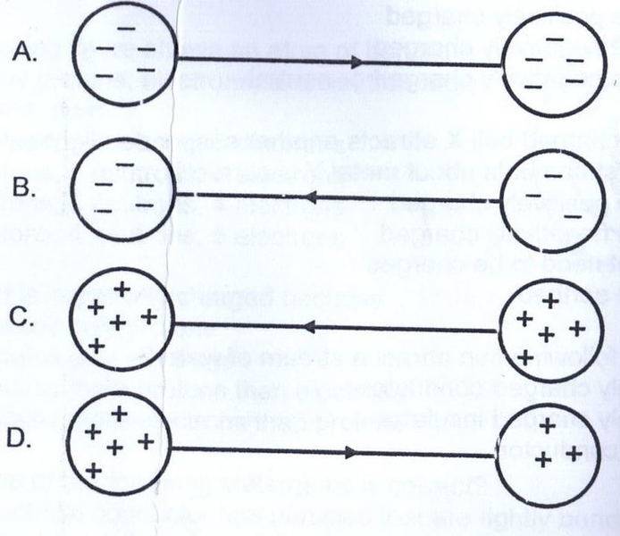

4. Which of the following figures shows a current of electrons?

4. I guess there is no right answer in the choices. Electrons will flow from more negative to more positive object. (a) and (c) have the same amount of charge so they are neutral compared to each other. for (b) the electrons should flow from left to right because left one is more negative. for (d) electrons should flow from right to left because the left one is more positive.
Right or wrong?
Right or wrong?
It is right, as the flow of electrons was the question.
