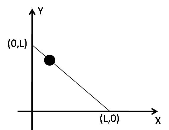

Electric field given by the vector [itex]\vec{E}=x\hat{i}+y\hat{j}[/itex] is present in xy plane. A small ring carrying charge +Q, which can freely slide on a smooth non conducting rod, is projected along the rod from point (0,L) such that it can reach the other end of the rod. What minimum velocity should be given to the rod? (Assume zero gravity).
I tried finding the change in potential, finding the work done and equating the work done to kinetic energy. Let's assume that it moves a very small displacement dr as shown in the figure.
It will have components dx[itex]\hat{i}[/itex] and -dy[itex]\hat{j}[/itex].
∴[itex]dr=dx\hat{i}-dy\hat{j}[/itex].

dr =dxi+dyj regardless of the direction of the of the path.

Yes. The change of potential is zero between the initial and final points, but it has a maximum somewhere in between. The kinetic energy has to overcome that maximum potential.
Think: You stand at a fence and you want to throw a ball over the other side. . How much must be the kinetic energy of the ball? You can not say that it is PE(f)-PE(i)=0...
ehild

The field is radial so the potential difference between (0,L) and (L,0) will be 0. However. along the path, the ring will gain potential energy until it is at it's nearest to the origin and then lose it. So take the potential difference between (0,L) and where the ring is nearest the origin in a similar approach as you did.

NO. Find it. Write up the potential along the path as function of the distance from the initial point, and find the local maximum.

You need the maximum along the straight line from (0,L) to (L,0). If s is the distance from the initial point, x=s/√2 and y=L-s/√2. Write the potential energy in terms of s.

The point charge moves along the blue line. The equation of that line is y=L-x. If the point has started from the upper end, and traveled s distance, it is in point x,y: x=s/√2 (as the line encloses 45°angle with the x axis) and y=L-s/√2.
You derived already that the potential is -1/2(x^2+y^2) with respect to the origin as reference point. In terms of s , it is
V=(-1/2) [(s/√2)2+(L-s/√2)2].
The maximum is when s=L/√2, and this corresponds to the point (L/2;L/2) as you wrote before. The potential is -L^2/4, but you need the change of potential from point (0,L), where it is -L^2/2. The difference is ΔV=L^2/4. You get the same result with integrating along the line from (0,L) to (L/2;L/2); you made simply a sign error in post #7.

Yes, and (L/2;L/2 was correct, I made some mistakes, too, sorrrrrrry...
Have you got the correct result at last?
ehild
Yes you are right, i did a mistake while integrating. Thanks for all the help ehild! :smile:
I have got the right answer.
