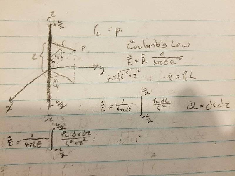

Hey guys, could anyone tell me if set up this integral correctly? Thanks in advanced!
No, it is not set up correctly. You should not have a double integral. The element of charge at position z is dq = (q/L)dz. Parameter r is the constant distance to the wire from the point where you want to know the field. You do not integrate over r because you want the field as a function of r.
On Edit: What is the z-component of the position vector of the point of observation P? That should also be made part of the integrand unless you want to calculate the field at the perpendicular bisector, but your drawing does not show that.

Yeah I noticed shortly after posting this that I didn't even have the correct amount of integrals for the differentials. Wouldn't that just make the integral (on mobile so I apologize for bad formatting):
1/(4piEr^2)* int(charge density*dz)
over the length of the line?
Don't I have to account for the angle each section of the charge is compared to the selected point?

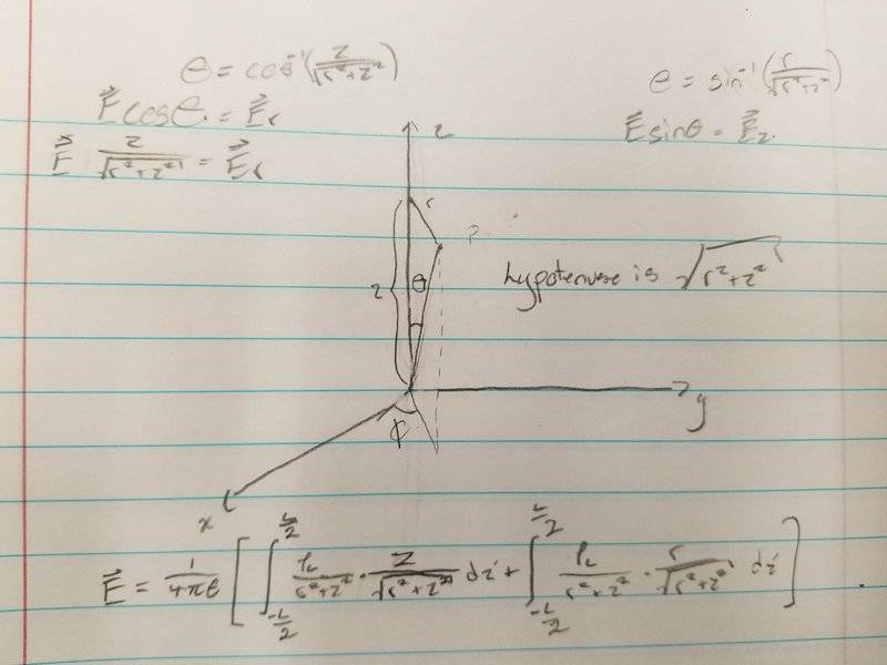

Yes, I guess I should preface this by saying I'm currently doing this for my electromagnetics class as a third year engineering major, so I do have plenty of experience with vector calculus. That being said I probably worded my previous question poorly haha.
In other words, in order to find the separate r and z component contributions in the line charge, I need to multiply the integrand by sine of the r component, and in a separate integral, cosine for the z component, then add them afterwards correct?
Jayalk97 said:
In other words, in order to find the separate r and z component contributions in the line charge, I need to multiply the integrated by sine of the r component, and in a separate integral, cosine for the z component, correct?
Correct. I think you understand what to do, but show me the two integrals just to make sure you are on the right track. A new drawing defining the quantities will also be helpful in checking your work.
Here. Would this be the correct integral?
No. I thought you understood but you did not. Let me make that drawing that I had in mind.

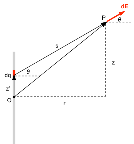

Here is the promised picture. Point P is at coordinates {##r##,##0##,##z##} with respect to origin O.
You have element ##dq =(q/L)dz'## on the line at distance ##z'## from the origin. It contributes element ##d\vec E## to the field at P. The distance of ##dq## from P is ##s##. Your task is to
1. Find the magnitude of ##d\vec E##.
2. Find expressions for the components ##dE_r## and ##dE_z## of ##d\vec E##. Express all distances and trig functions in terms of ##z##, ##z'##, ##r## and ##L##.
3. Integrate ##dE_r## and ##dE_z## over the length of the rod.
