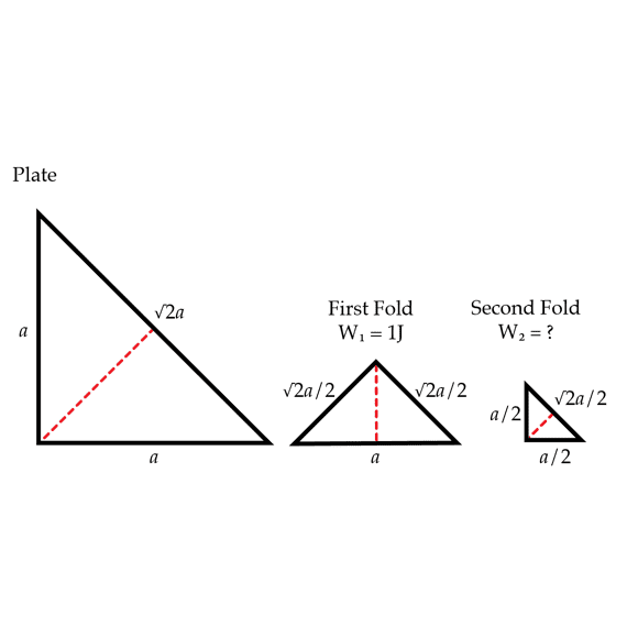

I don't think the given problem requires me to find an expression of potential energy as a function of the equal side lengths. Also, I am not sure how would I set up the integral even if I want to find the expression for potential energy. There is probably some trick to this question but I am honestly clueless about it.
Any help is appreciated. Thanks!

I would actually recommend that you position the triangle exactly as shown in the first figure, with the x-axis rightward and the y-axis upward, and the right angle at the origin. You won't actually have to integrate that, so don't worry about having to express the other boundary.

To perform a fold, it seems to me that the only quantities that the work can depend on are the initial charge density ##\sigma## and the initial leg length ##a## (as well as Coulomb's constant). That should be enough to get the answer.
But, maybe I'm being naive :redface:
Hi TSny! :)
TSny said:
Are you sure we you can't solve this with just dimensional analysis?
So ##W \propto k\sigma^ma^n##. From dimensional analysis, I get ##m=2## and ##n=-1##. Hence, ##W\propto \sigma^2/a##.
When the plate is folded, the surface charge density gets doubled and the sidelength gets reduced by a factor of ##\sqrt{2}##. Hence
$$\frac{1}{W_2}=\frac{1}{4\sqrt{2}} \Rightarrow W_2=4\sqrt{2} \,J$$

How did you get ##n = 1##? Remember, ##\sigma## is a charge density, not a charge.
