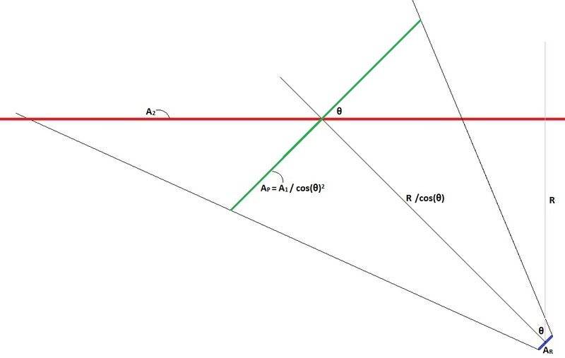

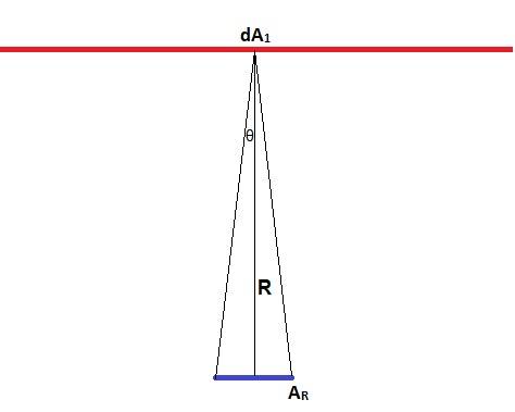

  • #181
JohnnyGui said:
Great. So if the first integration over ##dA_1## for ##E## isn't needed, then the first integration formula would collapse to ##\frac{I_0 \cdot cos(\theta)^4}{R^2} = E##. Now for the second integration this would mean, according to post #110:
$$\int \frac{I_0 \cdot cos(\theta)^4}{R^2} \cdot dA_2 = P_{A_2} = T^4_2 \cdot \sigma \cdot A_2$$
This means that ##E = T^4_2 \cdot \sigma## and ##P_{incident} = T^4_2 \cdot \sigma \cdot A_1##.
Correct?
100 "likes". You got it correct. One minor correction or two though: Change the ## I_o ## to an ## L _2 ##, and instead of a ## P_{A_2} ## on the right side, call it ## E ##. And leave off the last ## A_2 ##. (Note: ## L_2=\frac {\sigma T_2^4}{\pi} ##).

  • #183
JohnnyGui said:
As much as I'm glad that I got it mostly correct, after typing the previous post I realized something XD.
If I have calculated that ##\frac{I_0 \cdot cos(\theta)^4}{R^2} = E## for the whole surface ##A_1## from one ##dA_2##, doesn't this mean that ## \int E \cdot dA_2## would give me the ##E## for surface ##A_1## but from the whole surface ##A_2##? This would lead me to conclude that ##E = T^4_2 \cdot \sigma \cdot A_2## and that ##P_{incidence} = T^4_2 \cdot \sigma \cdot A_2 \cdot A_1##.
What is it that I'm reasoning wrong here?
This is readily corrected: Your elemental source on surface ## A_2 ## is ## dI_2=L_2 \, dA_2 \, cos(\theta) ##, and ## dE_{perpendicular \, to \, path}=\frac{dI}{s^2}=\frac{dI}{R^2} cos^2(\theta) ##. Finally ## dE=dE_{perpendicular \, to \, path} cos(\theta) ##, (where ## dE ## refers to irradiance onto surface ## A_1 ##), so that ## \\ ## ## E=\int \frac{ L_2 cos^4(\theta)}{R^2} \, dA_2 ##. ## \\ ## (To make things more clear, I re-derived the ## cos^4(\theta) ## term here.) ## \\ ## Note that ## L_2=\frac{ \sigma T_2^4}{\pi} ##. ## \\ ## (Note the distance ## s=\frac{R}{cos(\theta)} ## in the inverse square law. Note also the ## cos(\theta) ## dependence for the elemental source ## dI_2 ##. Comes from ## I_o=LA ##, and ## I(\theta)=I_o cos(\theta) ##). ## \\ ## Upon evaluating this integral, the result will cancel the ## \pi ## in the denominator of the expression for ## L_2 ## giving ## E=\sigma T_2 ^4 ##.

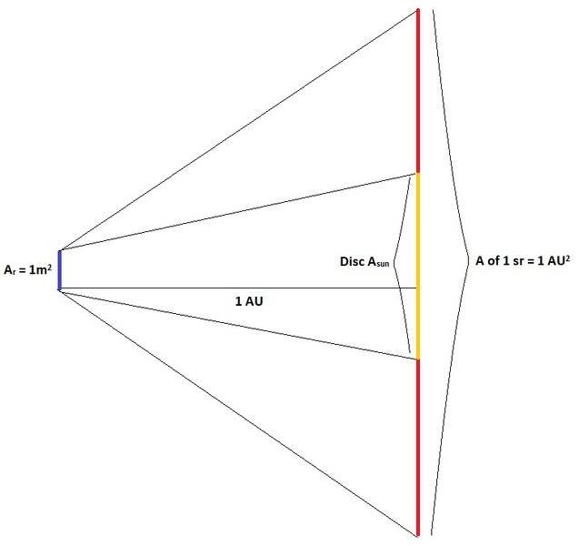

  • #201
The spectral radiance function ## L(\lambda, T ) ## is the one that is most commonly presented in the literature. If you find that ## M(\lambda, T) ## is the function that you prefer to work with, in presentations and/or for your own use, all you need to do is multiply all of the ## L(\lambda, T) ## results by ## \pi ##. ## \\ ## For your second question above, the discussion concerns the case where surface ## A_2 ## encloses surface ## A_1 ##. ## \\ ## And for your 3rd comment, I'm glad that you find the Planck spectral function of much interest. The Planck function IMO is one of the more important successes of Quantum Mechanics, and it adds a very important detail to the much simpler radiant emittance ## M=\sigma T^4 ##. Knowing the spectral content is important in determining how much visible light that a source is generating. :) ## \\ ## In studying the general behavior of the Planck function, that the area under the curve increases dramatically with temperature and is ## \frac{\sigma T^4}{\pi} ##, be sure to also learn Wien's law (which can be derived by taking the derivative of ## L(\lambda, T) ## w.r.t. to ## \lambda ## and setting it equal to zero), that ## \lambda_{max}T= 2.898 E+6 ## nm K, where ## \lambda_{max} ## is the wavelength where ## L(\lambda,T ) ## has its peak. At ## T=6000 ## K, (the approximate temperature of the outside surface of the sun), the peak of ## L(\lambda, T) ## occurs at ## \lambda_{max}=500 ## nm (approximately).## \\ ## By Wien's law, the peak goes to shorter wavelengths as the temperature increases. In general, almost exactly 25% of the energy always lies to the left of the peak. (An in-depth analysis with a fair amount of computing shows the fraction to the left of the peak is not exactly .25, but more precisely .25005...). In any case this fraction is very nearly 25%, independent of temperature. ## \\ ## Another result that is of interest is that the value of ## L(\lambda,T) ## at its peak, ## L(\lambda_{max}, T ) ##, is found to be proportional to the 5th power of the temperature.
  • #202
@JohnnyGui Please read post #201, but there is one somewhat simple additional calculation that I think you would find worthwhile involving blackbodies: ## \\ ## If you treat the sun as a blackbody at temperature ## T_s=6000 ## K, and compute the total power radiated using the radius of the sun ## R_s=7.0 E+8 ## m, you can compute the approximate average temperature of the Earth ## T_e ## if you assume the Earth to be a blackbody that absorbs all of the energy from the sun that it intercepts, and assuming it radiates as a blackbody (at the temperature ## T_e ## that we are calculating) over its entire surface, and that a dynamic equilibrium has been reached so the radiated power of the Earth is the same as the power that it receives from the sun. The radius of the Earth is ## R_e=6.4 E+6 ## m, and the distance from the sun to the Earth ## s_{se}=1.50 E+11 ## m. ## \\ ## The calculation simply uses ## M=\sigma T^4 ## and does not use the Planck function as part of this computation. ## \\ ## Perhaps one of the trickier, but still simple, parts of the calculation is to observe that the Earth as seen from the sun appears to be a circle of area ## \pi R_e^2 ##, so that the fraction of power from the sun that it intercepts is ## \frac{\pi R_e^2}{4 \pi s_{se}^2} ##. Anyway, I thought you might find this calculation of interest.
  • #203
Charles Link said:
If you treat the sun as a blackbody at temperature Ts=6000Ts=6000 T_s=6000 K, and compute the total power radiated using the radius of the sun Rs=7.0E+8Rs=7.0E+8 R_s=7.0 E+8 m, you can compute the approximate average temperature of the Earth TeTe T_e if you assume the Earth to be a blackbody that absorbs all of the energy from the sun that it intercepts
Thanks for the exercise! I read that first sentence of your post and decided to reason the calculation by myself before reading the rest of it. I'm happy to say that I reasoned that the receiving surface of the Earth can indeed be estimated as ##\pi R_E^2## and that it will radiate from a surface of ##4 \pi R_E^2##.
