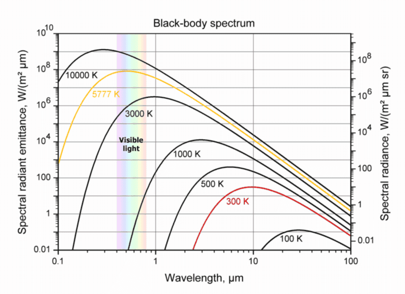

I get what you're saying. But the reason I find this possible is because ##\epsilon(\lambda)## differs with wavelength. So looking at the blackbody spectra at different temperatures:
Looking at the red line of ##300K##, the emissivity ##\epsilon(\lambda)## of the object could be for example 1 for the wavelengths corresponding to that ##300K## line while it could be very low for the wavelengths corresponding to the ##10000K## line. Since the ##10000K## line has a higher total energy when integrated but is compensated by the low emissivity, there is a possibility that the total absorbed energy from that ##10000K## line at a low emissivity is equal to the total absorbed energy from the ##300K## line at a high emissivity. (I see that the ##10000K## line also covers the wavelengths from the 300K line but emissivity can also change due to a higher temperature itself so that it is lower for those ##300K## wavelengths at ##10000##).
Isn't this possible?
  • #250
The answer is no, it is not possible. In your last equation of post #247, every single term ## \epsilon (\lambda) M_{bb} (\lambda, T_{walls}) ## of the integral on the left hand side of the equation is greater than the corresponding term ## \epsilon(\lambda) M_{bb} (\lambda , T_{ambient}) ## on the right hand side of the equation for ## T_{walls}>T_{ambient} ##. The emissivity ## \epsilon (\lambda) ## is the same for both terms. For the same ## \lambda ##, we don't have two different ## \epsilon (\lambda) ##.

You're right, the 10000K line also covers the wavelengths from 300K at a higher energy level. It might be farfetched but what if emissivity also changes with temperature itself so that it is specifically low for the wavelengths from 300K when it's at 10000K?
  • #252
Very far-fetched. What you are proposing is that since ## \epsilon=\epsilon(\lambda,T) ## that the two ## \epsilon(\lambda) ## are not necessarily the same for the left integral and the right integral (for ## T=T_{walls} ## on the left and ## T=T_{ambient} ## on the right), that in an extreme case of emissivity varying with the temperature, that it might be possible. Mathematically, perhaps, yes, but in a real physical system, it's not going to do that. This would basically be a system for which you reach equilibrium without having thermal (temperature) equilibrium. It just doesn't happen that way.
