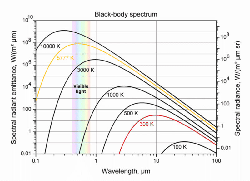

The discussion revolves around the emission spectra of different materials, particularly focusing on incandescent light bulbs and the relationship between temperature, filament design, and emitted wavelengths. Participants explore concepts related to black body radiation, Wien's law, and the factors influencing the temperature and color of emitted light.
  • Some participants question how incandescent light bulbs can emit different colors of light (yellowish vs. white) despite varying temperatures, suggesting that temperature alone does not determine emitted color.
  • Others argue that the design of the filament, including its thickness and surface area, affects the temperature and color of light emitted, with thicker filaments running cooler and producing redder light.
  • There is a discussion about the implications of Wien's law, with some participants asserting that it indicates different temperatures should yield different peak wavelengths, while others challenge this interpretation.
  • Participants mention that hot objects emit a continuous spectrum, and the peak wavelength is not the only factor in determining the color of emitted light.
  • Some contributions involve mathematical relationships between resistance, surface area, and temperature, with varying opinions on how these factors interact.
  • One participant emphasizes that equilibrium temperature is influenced by surface area and power supplied, rather than heat capacity or time to reach temperature.
  • There is a technical exchange regarding the resistance of wires and how it relates to surface area, with differing views on the significance of these relationships.
Participants express differing views on the relationship between temperature, filament design, and emitted light color. There is no consensus on how these factors interact, particularly regarding Wien's law and the implications for incandescent bulbs.

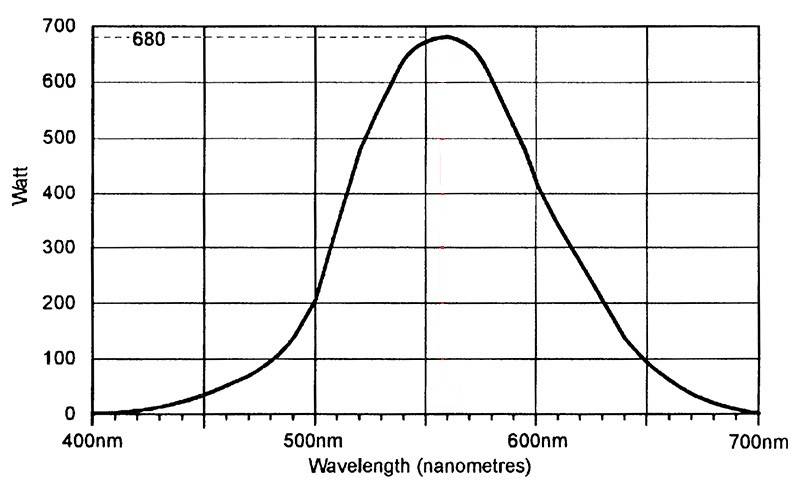

Great, I think I'm starting to understand how the integrals are used in this subject.
Are you familiar with the quantities based on the human's eye sensitivity? I've been reading about it and I noticed that they're basically analogues to the quantities of radiant energy that we've discusses so far, but each emitted wavelength corrected for the eye's sensitivity w.r.t. 555 nm at 1/683 Watts to give the units of Lumens. So far I've concluded the analogues as follows:
- Luminous Flux is the analogue of Radiant Flux
- Luminous Intensity (candela as unit) is the analogue of Radiant Intensity
- Emittance/Luminous Exitance is the analogue of Emissive Power
- Illumination/Illuminance (Lux as unit) is the analogue of Irrradiance
- Luminance is the analogue of Radiance
Are these correct?

I'm not sure if you can help me but there's something regarding the calculation of the Luminous flux (##\phi_v##) that has been bothering me for quite a while now which I still can't seem to grasp.
Let's say a radiating source is emitting a range of wavelengths, each wavelength at (obviously) a different amount of Watts. The amount of Lumens of one specific wavelength ##\lambda_1## is given by multiplying the amount of Watts that ##\lambda_1## is emitted at with 683 (1 Lumen is at 1/683 Watts) and then by the luminosity function ##\bar y(\lambda_1)## that indicates how sensitive that ##\lambda_1## is to the eye with respect to a wavelength of 555 nm (it's a dimensionless number, ##\bar y## at 555 nm being equal to ##1##).
If the above calculation is for one specific wavelength, one would have to integrate over the whole spectrum range that the source is emitting to know the total amount of Lumens. The Wiki shows the following formula:
The ##\phi_{e,\lambda}## is the spectral radiant flux in Watts/nm.
Here's what I don't get. If a spectrum range is a continuous range of emitted wavelengths, shouldn't one have to calculate the amount of lumens (or just the energy for that matter) of each infinitesimally small wavelength increase? So for example starting from a wavelength of 500nm:
$$683.002lm/W \cdot (500nm \cdot Watts(500nm) \cdot \bar y (500nm) + 500.00001nm \cdot \bar y(500.00001) \cdot Watts(500.00001) + 500.00002nm \cdot Watts(500.00002) \cdot \bar y (500.00002nm) + ...)$$
The problem is that one could take even smaller steps in wavelength increase (0.00000...001) and I'm not sure where the limit is. The ##d\lambda## in the formula above indicates that in very small range of different wavelengths, each wavelength is emitted at the same spectral radiant flux and has the same sensitivity ##\bar y##.
I have a feeling this is a general integration misunderstanding rather than a misunderstanding regarding calculating the Luminous flux.
  • #137
The intensity spectrum ## \Phi(\lambda) ## is a density function, so that ## \Phi(\lambda) \, \Delta \lambda ## is the amount of energy between ## \lambda ## and ## \lambda + \Delta \lambda ##. ## \\ ## You could make the analogy of letting your spectrum be represented by a football field and spreading a bunch of dirt all over it to make some hills. If you put 1000 lbs. of dirt on the field in some distribution, how much did you put at the 50 yard line? You can't give a number to that unless you know the width of the interval: e.g. 50 yds. +/- 1 yard, or 50 yards+\- 1 ft. ? There is a density of dirt that is given by pounds per yard spread across the field. If you want to know how much is at 50 yard line in an interval one foot wide, you multiply the density (in pounds per yard) by the ## \Delta x ## one foot=1/3 yard. ## \\ ## In calculating the amount of energy in the spectrum, the summation is done with an integral, but you can also numerically evaluate the integral by using a small interval ## \Delta \lambda ## and doing the computation over say 100 or 1000 points in the spectrum. The ## \Delta \lambda ## is the distance between the points. You get basically the same answer if you use 100 points across the spectrum and the ## \Delta \lambda ## corresponding to those 100 points, or 1000 points and a ## \Delta \lambda ## 1/10 the size of the previous one. Of course, the higher resolution (more points) gives more accuracy, i.e. you need to use enough points to get an accurate answer. (You of course don't need 1 million points to get good accuracy though.)
  • #138
I think I'm starting to get this now. Can I say that the ##\Phi(\lambda)## in W/nm is actually the slope of the spectrum curve of a radiating source?
  • #139
JohnnyGui said:
I think I'm starting to get this now. Can I say that the ##\Phi(\lambda)## in W/nm is actually the slope of the spectrum curve?
The same thing comes up in probability distribution functions and probability density functions. ## F(x)=\int\limits_{- \infty}^{x} f(t) \, dt ##, where ## F(x) ## is the probability distribution function and ## f(x) ## is the probability density function. You can take the derivative of ## F(x) ##, and yes, ## F'(x)=f(x) ##. In this case the spectral density function ## \Phi(\lambda) ## corresponds to ## f(x) ##, and normally the equivalent of ## F(x) ## is not tabulated here. ## \\ ## With the football field analogy, ## F(x) ## would be the sum total of dirt to the left of the position ## x ##. With your spectrum, the function for which you want to take a derivative is not computed or tabulated. You could compute it yourself (numerically), and you would find its derivative is indeed ## \Phi (\lambda) ##, but in this case, the function you mentioned normally is not used in this application. They simply tabulate the spectral density function ## \Phi (\lambda) ##. ## \\ ## So to answer your question, can you say ## \Phi(\lambda) ## is the slope of the spectrum curve? The answer is not really. Your idea is a good one, but they simply don't tabulate that function in this application. (Alternatively, in probability theory, the function ## F(x) ## is often tabulated.)

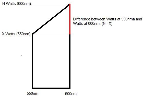

I think I have found an alternative way to show why ##\Phi(\lambda)## is not the slope of a spectrum curve, although I'm not sure it's the correct way to explain this. Consider the following spectrum curve that shows many watts each wavelength is emitted from a source.
Say I'd want to calculate the energy from the left side of this curve, starting from 400nm, up to the peak wavelength (around 560 nm) that is emitted at 680 Watt as shown.
If ##\Phi(\lambda)## is the slope (i.e. derivative) of this curve in Watts/nm, then integrating ##\Phi(\lambda)## would only give the difference in Watts between 400 nm and 560nm, which is 680 Watts. Correct?
So, this means that ##\Phi(\lambda)## must be the function of the curve itself since integrating the function of the curve itself would give the area beneath it.
Is this reasoning correct?
  • #141
Let ## A(\lambda)=\int\limits_{0}^{\lambda} \Phi(\lambda ') \, d \lambda ' ##, then ## \frac{d A(\lambda)}{d \lambda}=\Phi(\lambda) ##. ## \frac{d A(\lambda)}{d \lambda } ## is of course the slope of ## A(\lambda) ## vs. ## \lambda ## at any point. In spectroscopy, (unlike probability theory where the integral (area under the curve) of the Gaussian distribution is often tabulated), the function ## A(\lambda ) ## simply isn't in widespread use. Editing: I should qualify the last statement: Many times the integration of ## \Phi(\lambda) ## is performed between two wavelengths to get ## P=\int\limits_{\lambda_1}^{\lambda_2} \Phi(\lambda) \, d \lambda ##, but this is done without ever tabulating ## A(\lambda) ##. The power ## P=A(\lambda_2)-A(\lambda_1) ##, but ## \Phi(\lambda) ## is normally tabulated, and I think I can say I have never seen a table of the function ## A(\lambda) ## in any spectroscopic publication. Mathematically, it could be done this way, but it simply isn't.
  • #142
Charles Link said:
Let ## A(\lambda)=\int\limits_{0}^{\lambda} \Phi(\lambda ') \, d \lambda ' ##, then ## \frac{d A(\lambda)}{d \lambda}=\Phi(\lambda) ##. ## \frac{d A(\lambda)}{d \lambda } ## is of course the slope of ## A(\lambda) ## vs. ## \lambda ## at any point. In spectroscopy, (unlike probability theory where the integral (area under the curve) of the Gaussian distribution is often tabulated), the function ## A(\lambda ) ## simply isn't in widespread use. Editing: I should qualify the last statement: Many times the integration of ## \Phi(\lambda) ## is performed between two wavelengths to get ## P=\int\limits_{\lambda_1}^{\lambda_2} ##, but this is done without ever tabulating ## A(\lambda) ##. The above ## P=A(\lambda_2)-A(\lambda_1) ##, but ## \Phi(\lambda) ## is normally tabulated, and I think I can say I have never seen a table of the function ## A(\lambda) ## in any spectroscopic publication.
So if I understand correctly ##A(\lambda)## is the total energy in a chosen wavelength range of the spectrum curve shown in my previous post. And ##A(\lambda)## has the derivatie ##\Phi(\lambda)## which is the function of the spectrum curve? (apologies if I misunderstood your post)
  • #143
JohnnyGui said:
So if I understand correctly ##A(\lambda)## is the total energy in a specific wavelength range of the spectrum curve shown in my previous post that has the derivatie ##\Phi(\lambda)## which is the function of the spectrum curve? (apologies if I misunderstood your post)
Starting at the left end of the curve, yes, ## A (\lambda) ## is the area under the curve up to (and including) wavelength ## \lambda ##. It is analogous mathematics that distance ## s(t)=\int\limits_{0}^{t} v(t') \, dt' ## and ## \frac{d s(t)}{dt}=v(t) ##. If you have a graph of the velocity ## v ## vs. time ## t ##, the area under the curve is the distance traveled. Meanwhile on a graph of ## s ## vs. ## t ##, ## v=\frac{ds}{dt} ## is the slope of that graph at any point.

I think your analogy with the velocity-time diagram made me find the culprit. My spectrum graph shown in post #140 has a y-axis in Watts, and not in Watts/nanometre. Hence if you integrate a function that has Watts/nm as units (##\Phi(\lambda)##) you'll merely get the difference in Watts between the 2 chosen wavelengths in my Watts vs ##\lambda## spectrum curve in post #140.
So with your mentioned example of integrating ##\Phi(\lambda)## between ##550nm-600nm##, in a Watts vs ##\lambda## graph this would give give the following answer:
However, in a graph of Watts/nm vs ##\lambda##, integrating ##\Phi(\lambda)## would give the area under that Watts/nm vs ##\lambda## graph.
So my question is; if I'm using a Watts vs ##\lambda## graph (like in my post #140) instead of a Watts/nm vs ##\lambda## graph, and I want to calculate the energy within a specific wavelength range using that graph, shouldn't I integrate a function other than ##\Phi(\lambda)## to get the area under that Watts vs ##\lambda## graph? Is that the step by step numerical calculation that you were talking about in your post #145?
  • #147
I do believe you have most of it figured out. Good work ! ## \\ ## In your post #140, that graph is clearly mislabeled on the y-axis and it should read watts/nm. Sometimes, the per nm designation is understood, but it really belongs in the label on the y-axis. ## \\ ## Just an additional comment: With these spectral curves, you always compute the area under the curve=you don't take a difference such as ## N-X ##. In that particular instance, I think you are trying to do something that is incorrect. These spectral curves are ## \Phi(\lambda) ## type curves in all cases (e.g. per unit wavelength). They are not ## A(\lambda) ## type curves. If you were showing a graph of ## A(\lambda) ## vs. ## \lambda ## in post 146, then what you did is correct, but again, it simply is never done that way in spectroscopy. ## \\ ## (And to say it again=it is a common technique in probability theory to tabulate the integrated curve ## A(\lambda) ##. The two letters they typically use are ## F(\lambda) ## (for the integrated), and ## f(\lambda) ## for what they call the probability density function, but the spectroscopists do it without the ## A(\lambda) ##).
  • #148
This has been bothering me for a long while and I can't believe this was actually the culprit. Thanks a lot for explaining this!
Let's say I'm very stubborn and I want to use the graph in my post #140 with just Watts on the y-axis vs ##\lambda## to calculate the energy between 550nm-600nm. Should I read off the amount of Watts for each wavelength within 550-600 nm and add them all together? Or would this still give an incorrect answer?
  • #149
When they make what is really a mistake with their units on the y-axis, you need to question whether the numbers such as 600 and 700 watts/nm are correct, but using those numbers, when integrating this source, the answer that you get it that it has about 70,000 watts of radiated power. (I estimated this by taking 500 watts/nm at the shoulders near the peak multiplied by a width of about ## \Delta \lambda=100 ## nm, (for wavelength ## \lambda ## from 600 nm to 700 nm) and then observing the entire area under the curve might be about 35% more). It general, I would recommend finding a book that gets the units correct, but it still made for a useful diagram. ## \\ ## Note: In computing these integrals numerically, it is much easier to use a lower resolution , e.g. ## \Delta \lambda=10 \, nm ## or even ## \Delta \lambda =100 \, nm ##. The summation you do is ## \sum\limits_{i} \Phi(\lambda_i) \, \Delta \lambda ##. (At higher resolution=smaller ## \Delta \lambda ##, there are more ## \Phi(\lambda_i) ## terms in the sum. At low resolution (e.g. ## \Delta \lambda=100 \, nm ## ), you might have i=1 to 10. At very high resolution (e.g. ## \Delta \lambda=1 \, nm ##), you would then have i=1 to 1000, etc.) As I showed in post # 145, you can do it at various resolutions, but there is no reason to use ## \Delta \lambda=1 \, nm ##. When the spectral curve has little structure, you can get a very accurate answer with a low resolution summation. If you followed the explanation of how I estimated 70,000 watts, I basically computed the integral at a resolution of ## \Delta \lambda=100 \, nm ##. If you compute it at ## \Delta \lambda =1 \, nm ## resolution, it might take you 30 minutes or more by hand ,(of course you can simply use a spreadsheet and let the computer do the work), and most likely you will still get an answer for the area under the entire curve of about 70,000 watts.
  • #150
Charles Link said:
When they make what is really a mistake with their units on the y-axis, you need to question whether the numbers such as 600 and 700 watts/nm are correct, but using those numbers, when integrating this source, the answer that you get it that it has about 70,000 watts of radiated power. (I estimated this by taking 500 watts/nm at the shoulders near the peak multiplied by a width of about Δλ=100Δλ=100 \Delta \lambda=100 nm, (for wavelength λλ \lambda from 600 nm to 700 nm) and then observing the entire area under the curve might be about 35% more). It general, I would recommend finding a book that gets the units correct, but it still made for a useful diagram. \\ Note: In computing these integrals numerically, it is much easier to use a lower resolution , e.g. Δλ=10nmΔλ=10nm \Delta \lambda=10 \, nm or even Δλ=100nmΔλ=100nm \Delta \lambda =100 \, nm . The summation you do is ∑iΦ(λi)Δλ∑iΦ(λi)Δλ \sum\limits_{i} \Phi(\lambda_i) \, \Delta \lambda . (At higher resolution=smaller ΔλΔλ \Delta \lambda , there are more Φ(λi)Φ(λi) \Phi(\lambda_i) terms in the sum. At low resolution (e.g. Δλ=100nmΔλ=100nm \Delta \lambda=100 \, nm ), you might have i=1 to 10. At very high resolution (e.g. Δλ=1nmΔλ=1nm \Delta \lambda=1 \, nm ), you would then have i=1 to 1000, etc.) As I showed in post # 145, you can do it at various resolutions, but there is no reason to use Δλ=1nmΔλ=1nm \Delta \lambda=1 \, nm . When the spectral curve has little structure, you can get a very accurate answer with a low resolution summation. If you followed the explanation of how I estimated 70,000 watts, I basically computed the integral at a resolution of Δλ=100nmΔλ=100nm \Delta \lambda=100 \, nm . If you compute it at Δλ=1nmΔλ=1nm \Delta \lambda =1 \, nm resolution, it might take you 30 minutes or more by hand ,(of course you can simply use a spreadsheet and let the computer do the work), and most likely you will still get an answer for the area under the entire curve of about 70,000 watts.
You mentioned here that this computation has to be done for a graph that has Watts/nm on the y-axis (a ##\Phi(\lambda)## vs ##\lambda## curve) right?
I might have misunderstood you, but I meant calculating the energy if the graph is a ##A(\lambda)## vs ##\lambda## curve (i.e. Watts on the y-axis instead of Watts/nm).
I might be blacking out again but here's what I find colliding:
For a ##\Phi(\lambda)## vs ##\lambda## curve that has Watts/nm on the y-axis, you'd have to integrate ##\Phi(\lambda)## for a certain wavelength range to calculate the energy. Just like integrating a ##v## vs ##t## curve between ##t_1-t_2## would give the distance ##s## traveled between ##t_1 - t_2## which is the distance ##s## at ##t_2## minus distance at ##t_1## in a ##s## vs ##t## curve, integration of ##\Phi(\lambda)## between ##\lambda_1 - \lambda_2## in a ##\Phi(\lambda)## vs ##\lambda## curve would give the energy between ##\lambda_1-\lambda_2## which is the energy at ##\lambda_2## minus the energy of ##\lambda_1## in a ##A(\lambda)## curve, if I understand this correctly.
However, say I now have a ##A(\lambda)## vs ##\lambda## curve which has Watts on the y-axis and I want to calculate the energy from that curve between ##\lambda_1-\lambda_2##. In this case, my instinct would say that I'd have to add up every amount of Watts corresponding to each wavelength between ##\lambda_1-\lambda_2## (with a high resolution for examle). Notice that this would NOT give the same answer as when I integrate ##\Phi{\lambda}## in a ##\Phi(\lambda)## curve between ##\lambda_1 - \lambda_2##, since that would merely give the difference of the energy between ##\lambda_1## and ##\lambda_2## in a ##A(\lambda)## curve.
You probably have been trying to explain me this the whole time, but I don't really get how I should calculate the amount of energy from a ##A(\lambda)## vs ##\lambda## curve to get the same amount of energy as integrating a ##\Phi(\lambda)## vs ##\lambda## curve.
