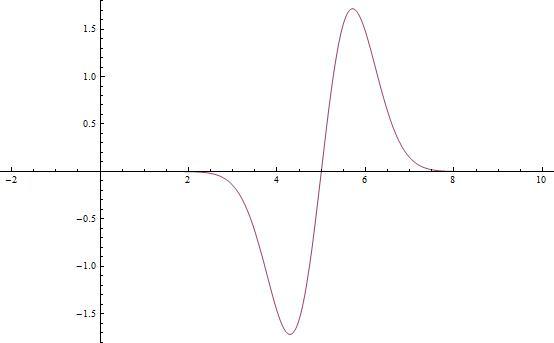

Ok, just to be clear, when you say that the speed is zero only in the centre of the string, you mean the central region where the wave pulses completely cancel each other out right, because I just don't see how particles anywhere in that region could possesses a non-zero velocity.
No, I mean the central point not the central region. The velocity of the string at a given time is a function of position, v(x).
It is zero for a specific value of x, (let's say x=xm, the middle point) and non zero for the points around xm. Of course, if the cord is long compared with the pulse widths the speed will be also zero for points far away from the pulses.
You can do it yourself. "Take" two identical Gaussian pulses (easy to calculate) that propagate in opposite directions, add them to get the total displacement and take the time derivative to calculate the distribution of the speed in the cord at any time, including at the time you are interested in.
Here is an example of a possible velocity distribution at the moment in question. The two pulses start from the x=0 and x=10 m and propagate with velocities of 1m/s. They meet in the center at x=5m at t=5s.
The plot represents v(x) at t=5 s.
To expand on this, in units where the speed of the wave is 1 you can write the equation of a wave moving to the right as:
f(x-t)
and a wave moving to the left as:
g(x+t)
In order to achieve complete destructive interference at t=0 we find:
g(x)=-f(x)
Then computing the velocity we find:
\frac{df}{dt}=-f'(x-t)
\frac{dg}{dt}=-f'(x+t)
So at t=0 (complete destructive interference) we find that the velocity adds constructively:
\frac{d(f+g)}{dt}\bigg|_{t=0}=-2f'(x)
