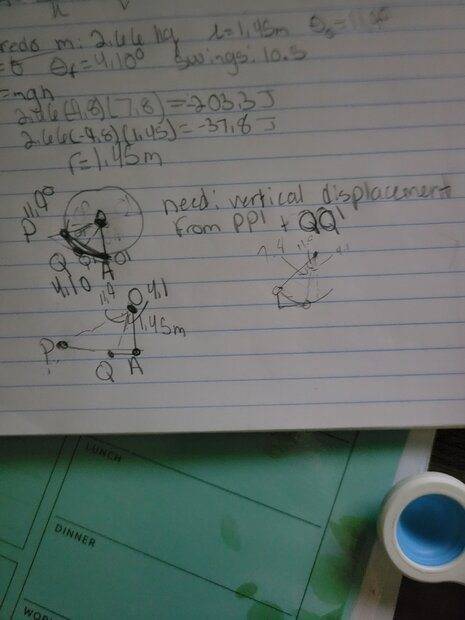

A 2.66-kg rock is attached at the end of a thin, very light rope 1.45 m long and is started swinging by releasing it when the rope makes an 11.9 ∘ angle with the vertical. You record the observation that it rises only to an angle of 4.10 ∘ with the vertical after 10.5 swings.
To be honest, I have no idea. The section of our chapter had nothing on equations and we didn't talk about this in class. My best guess would be E = 1/2mv^2 + 1/2kx^2.
yeah, I don't even know how to start
Where k and x are what, here?
I'm thinking x would be replaced with the angles, but I have no idea for k, especially as this is a rope and not a spring. The only other thing I'm given is that it's E-inital - E-final.

Drawing a diagram should be your first step.
Draw a circle of radius rope length. Centre, O, is where the rope is attached to a support.
Draw a vertical radius OA down from the centre to represent the rope at the bottom of its swing, and two more radii, OP, OQ from the centre making those two angles to the vertical.
Finally, horizontal lines from P and Q, meeting OA at P', Q'.
You need the vertical displacement from PP' to QQ'.
I'm sorry, I drew it out but it's not making sense.

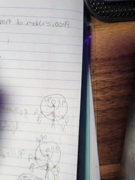

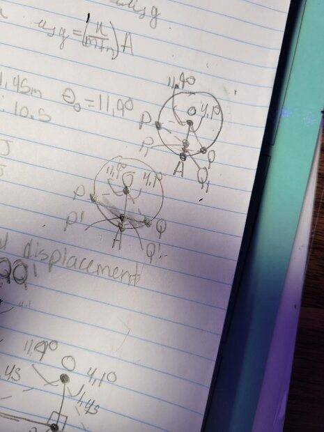

The distances OA, OP, OQ should all be the same. They lie on the circle (which you are now leaving out of the diagram). So A, P' and Q' will be at different heights
haruspex said:
The distances OA, OP, OQ should all be the same. They lie on the circle (which you are now leaving out of tge diagram). So A, P' and Q' will be at different heights
More like these, then?
vel said:
More like these, then?View attachment 288885
Unfortunately the image you posted only shows part of the best-looking diagram.

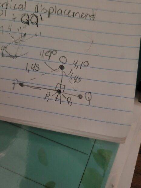

The very bottom one? that one doesn't have a circle, it's one I sent earlier (#20)
Yes, I see now it is just a truncated version of the same sketch. Oddly enough, the portion in post#23 is ok, it's the cut off part that's wrong.
But the other sketches in post #23 are still quite wrong. Why is it so hard for you to draw a HORIZONTAL line from P? You seem to insist on P' and Q' being the same point.

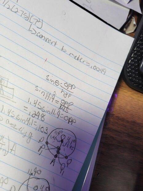

this would be a sine problem, so I went ahead and did that. See any issues there (or with the diagram?)?
vel said:
I didn't even realize I had it on an angle, lol.
Ok, now use trig to find distances OP' and OQ' in terms of the rope length and the angles.

I think we posted at the same time, lmao. I have the sine equations in #28. If I did it that all correctly and my line of thought is right, it should be PEgrav = 2.66(-9.8)(.401) = -10.45
