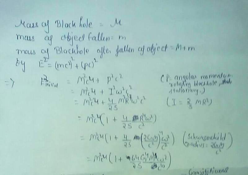

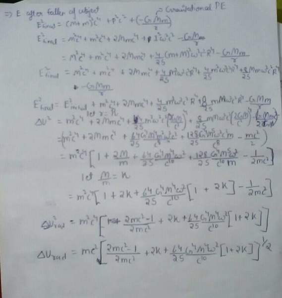

I'm trying to find how much energy will radiate when an object fell in a black hole.
Is my calculations are correct or I'd committed mistake somewhere?
Handwritten derivation: mass of black hole M, mass of object fallen m, black hole mass after capture M+m, energy-momentum relation E^2 = (mc^2)^2 + (pc)^2, then expansion with I = (2/5)MR^2 and Schwarzschild radius 2GM/c^2.
Handwritten derivation on lined paper of the energy of a falling object near a black hole, with expressions for E after fall, E_final and the change in energy, ending in an expression for ΔU_rad.
  • Handwritten derivation: mass of black hole M, mass of object fallen m, black hole mass after capture M+m, energy-momentum relation E^2 = (mc^2)^2 + (pc)^2, then expansion with I = (2/5)MR^2 and Schwarzschild radius 2GM/c^2.

  • Handwritten derivation on lined paper of the energy of a falling object near a black hole, with expressions for E after fall, E_final and the change in energy, ending in an expression for ΔU_rad.

You dropped a squared term on the 14th line.

At a conceptual level, I see a basic problem in your work. You are using special relativity formulas and Newtonian gravitational potential energy. These are both completely inapplicable to the situation. The simplest correct way to do this would be to use Post Newtonian approximation (linearized GR would not work because it doesn’t handle gravitational radiation).
This is not a simple undertaking. An example introduction to the field is:
https://www.physics.uoguelph.ca/poisson/research/postN.pdf
However, some simplification is possible in your scenario - the simplest body in GR is a BH, so handling the infall of a small body into a BH is equivalent to the so called extreme mass ratio BH merger. This allows so called effective one body methods, as discussed here:
https://arxiv.org/abs/gr-qc/0612096
Admittedly, this A level material not I level, but I don’t think there is meaningful way to handle the problem without advanced techniques.

So where am I wrong :
1. From the beginning
2. or, I took wrong gravitational PE
Riyan said:
So where am I wrong
Once more: you need to post your equations. Then we can quote them directly and help you. We can't quote anything from the image you posted.
Or, if posting the equations is too much, at the very least you can describe your solution strategy in words, step by step. Then we can at least quote the steps that might have issues.
Mass of black hole =M
Mass of object =m
Mass of object after fallen of object =M+m
\begin{align}
E^2 &=M^2 c^4+p^2 c^2
\\ &=M^2 c^4+I^2 \omega^2 c^2
\\&=M^2 c^4+\frac {4M^2 r^4 \omega^2 c^2 }{25}
\\&=M^2 c^4(1+\frac {4r^4 \omega^2} {25 c^2} )
\end{align}
Schwarzschild radius = 2GM/c^2
Mass of object =m
Initial energy of black hole:
\begin{align}
\end{align}
\begin{align}
=M^2 c^4(1+\frac {4 ( \frac {2 G M} {c^2} )^4 \omega^2} {25 c^2} )
\\&=M^2 c^4(1+ \frac {64 G^4 M^4 \omega^2} {25 c^{10}} )
\end{align}

Right here you have assumed that there is zero radiation. If the object radiates any energy away while it is falling in, then it cannot add its full mass ##m## to the black hole; that would violate conservation of energy. So these equations say that the object freely falls into the hole and emits zero radiation, adding its full mass to the mass of the hole.
Should just be ##Mc^2## (or ##M## if you use units where ##c = 1##, which is common, and highly recommended, in relativity problems). Spacetime is not flat, so you cannot use the equations of special relativity. The best you can do is to work in coordinates in which the black hole is at rest, and in those coordinates its energy is just its mass.
In your (2) and (6), what is ##\omega## supposed to be?
This equation is for initial energy of black hole just rotating with angular velocity ##\omega ##
This equation is in 1st image
I got problem in writing equation of 2nd page when object fall in the black hole
Similarly solving for E after fallen of object with an additional term Gravitational PE (-GMm/r)
I get :
##Urad=m c^2\sqrt {(\frac {2 m c^2-1} {2 m c^2}+2k+\frac {64 G^4 M^4 \omega^2 (1+2k)} {25 c^{10}})}##
Since I agree with Peter that a free falling test particle falling into any BH will radiate no energy (assuming mass is too small for gravitational radiation), I assumed you were asking about the nontrivial question of gravitational radiation. Note that GW emitted have nothing to do with potential energy difference (which can only be defined in stationary spacetimes in GR). Given your follow on questions, it appears you are asking much more elementary questions.
Ignoring GW, no matter whether the BH is rotating or not, any free fall of an uncharged test body into a BH will emit no radiation. This is simply because any KE or angular momentum acquired by conversion of PE to KE will be carried into the BH and not radiated. Gravitation radiation is the GR exception to this rule, and it is an inherently nonlinear effect as discussed int the papers I referenced.

This equation is for initial energy of black hole just rotating with angular velocity ##\omega##
Where are you getting this equation from? Black holes are not ordinary objects and don't obey the same equations as ordinary objects. The energy of a black hole is its mass.
Based on what you've said so far, I think it's #1.
