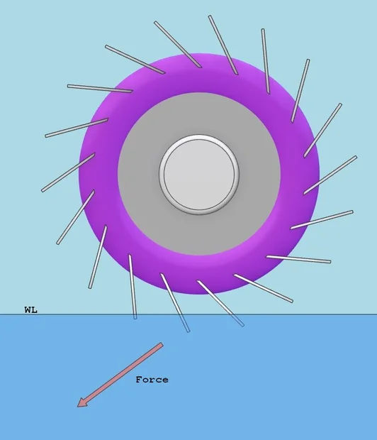

My problem is trying to calculate the amount of energy, or a good estimate, that would be required to keep the boat levitated above the water at the approximate water line shown in the second drawing.
I don’t believe it will require as much energy as a helicopter as the blades are pushing against a semi-solid surface but I really don’t know?
A planing hull has a lift / drag ratio of about 5:1 with skin friction becoming increasingly more dominate and at an exponential rate as speed increases.
Lets say in a static test with the boat tethered to the shore it was found that at a blade speed of 20 mph the required lift was achieved would that not be a constant such that at a boat speed of say 60 mph the blade would have to spin at 80 mph? Making the boat increasingly more efficient than a planing hull as speed increases. Exponentially more efficient?
* ignoring air resistance which applies to both in any case.

I get the feeling that when travelling, your wheels as shown have top-spin, which will tend to pull the wheels downwards and stick to the water. You will need back-spin, like an undercut ball, or a bouncing bomb, if you are to get lift. https://en.wikipedia.org/wiki/Magnus_effect
Spinning a wheel will displace water from under the wheel, so the wheel will drop into that hole. To lift the wheels, you need to pump water under the wheel, while preventing that water from escaping sideways. Tractor tires have a tread that scrapes or pumps surface mud out sideways from under the tire, until the tire can grip on the more solid material below. You need a tread, that is a blade profile on your wheels, that is the opposite of a tractor tire.
If hull buoyancy initially supports the craft, then the wheels are paddle wheels, and the hull must plane at speed. If you want lift from the spinning wheels to raise the hull clear of the water, you will need a different approach. The same wheels cannot propel you over a solid and a liquid surface. I am sorry I sound so pessimistic.

Why are the fin thingies facing backwards instead of forwards for the wheel rotation? That seems like the fins will just slip in the water instead of catching it and throwing it back to create thrust.
Edit/Add -- And do you understand the difference in efficiency of a propeller versus a paddlewheel for boat thrust?
Probably because they must plane on the surface, rather than dig in.
Traction is then from surface drag, with a drag coefficient proportional to the square of the wheel speed.
That would be definitely the situation when the boat is tethered to the dock. The paddles are pumping water away from a static location, and the only way to refill is with water flowing in from the surroundings. The refill rate will most likely not be adequate to refill the hole. The wheel spin rate at the dock should bear no linear relationship with spin rate necessary when under forward travel as the OP suggests.

Thanks for your input but I don't think the magnus effect applies. This is the interface between a gas and a liquid and the blades are simply push water in a downward and backward direction to create lift and forward propulsion.
OP idea is two fold:
Utilize the paddles to provide:
- propulsion
- lift the hull out if the water to reduce drag.

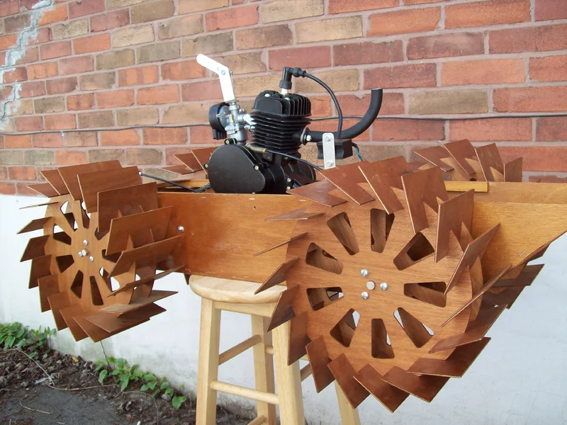

I did test a model years ago it did rise out of the water on a teather but then the motor died and that was that.
I imagine from the look that the hull was sunken at stop to axle depth, the vehicle being quite buoyant. Put some rocks in it to see its carrying capacity.
Well thanks for your replies but I was hoping somebody could provide some math as to the energy requirements?
I kept the wheels from the original model to use in an electric drive model but it would be nice to be able to refine the rquirements before hand.
