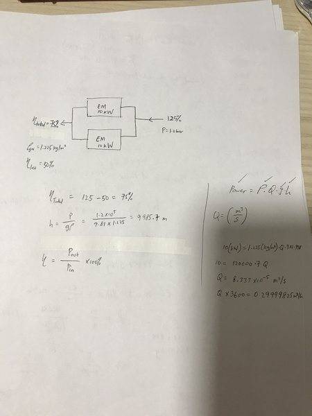

Any clue to to show that it is 10kW? Please tell me where i went wrong and thank you.
I tried and i just couldn't figure it out.

Only Q5b)
I would calculate the required flow rate first (125% of pumping requirement - from part a?), then the power required to move the gas. Then double that to account for the 50% loss in the fan. Then divide by two to get power of each fan.

For info: I notice you wrote "243kW" on the question sheet next to part a). If you multiply 234 * 100/65 you get 374kW.
I've just worked the numbers for Q5b and get a different answer to the book (eg not 10kW). I'll let you have a go before giving you my answer.
