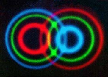

I have been thinking... (since I’m somewhat 'guilty' :wink:)
You know these things much better than me, and maybe this is not an 'issue', but what’s 'troubling' me is the fact the there’s one process creating the entanglement with a BBO crystal:
Overlapping concentric rings in blue, green and red on a black background, forming an interference-style pattern of two circular wave sources.
Then you perform a measurement at first PBS, but not 'reading' the value.
I’m just guessing here; but to me it looks like the wavefunction is decohered/collapsed after the first PBS... right?
If so, are you really sure that the second PBS can 'reinstall' the shared wavefunction and superposition state... (that normally takes a BBO to create)?
I’m mumbling here... what I want to say is – has the theory and work of French and Taylor + Eberly been tested physically?

As far as I know, it has not been tested in that form. There have been a number of experiments in which observations have been erased. So this is conceptually in line with that. As far as I know, there have been no experiments in which the final result is a superposition of parts of different photons. For example, in the diagram you have above: the overlapped area means that you have a superposition of particles. But neither particle has had to go through a polarization measurement. In fact, the bottom ring is known H> and the top is known V> (or vice versa). But in my version, each particle is "split" before the final superposition is created.
So I hope that makes it interesting and unique. :smile:

Just out of curiosity, is there any reason that the left hand rings are, from center, red, green, blue, whereas the right hand is, from center, blue, green, red. ??

Yes, that would be an indication that there is conservation. A little more dispersion on one side is related to a little less on the other.
