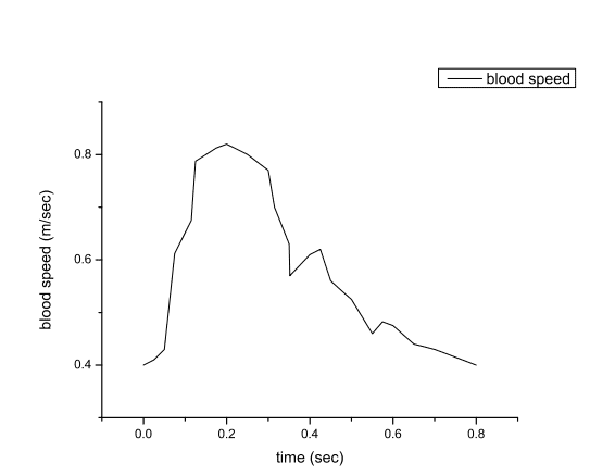

That is the data set that I was earlier talking about. I have included them in case someone wishes to plot them using Excel, Origin etc
I have included the graph that I have plotted using Excel. It is the Velocity profile of a carotid bifurcation artery and I want its exact equation.
My best approach goes with a 6th order polynomial fit but the ideal would be this exact scheme's equation
Line graph of blood speed (m/sec) against time (sec), rising from about 0.4 to a peak near 0.82 at 0.2 sec, then falling to about 0.4 at 0.8 sec, with small kinks along the curve.
  • Line graph of blood speed (m/sec) against time (sec), rising from about 0.4 to a peak near 0.82 at 0.2 sec, then falling to about 0.4 at 0.8 sec, with small kinks along the curve.

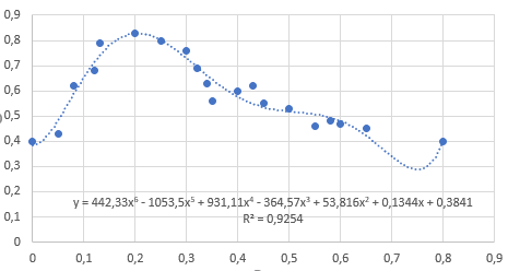

Scatter plot with a dotted fitted curve of y against x, both axes 0 to 0.9; curve rises to a peak near x=0.2 then falls to a minimum near x=0.75. Equation: y = 442.33x^6 - 1053.5x^5 + 931.11x^4 - 364.57x^3 + 53.816x^2 + 0.1344x + 0.3841, R² = 0.9254.
My attempt using a 6th order polynomial fit
In that case, you're going to need a physical model. There are infinitely many curves that will fit a finite set of points like this. You'll need to come up with a model that says "given heart systolic and diastolic pressures, I expect the velocity to be...", then find the pressures (and whatever else goes into your model - arterial diameters, heightn etc) that best fit your data.
If you don't have a model, all you are doing is smoothing your data somehow.
Note that your fit clearly has problems - presumably we're expecting this to cycle, and the slope at the right hand end is very different from the left hand end.

Perhaps if I am able to employ more data points, I could get a better approach with the polynomial fit. A physical model is not available. I just got these data by estimating the data points on the graph.
Another approach could be splitting the data set into pieces, according to its shape. That is, employing a polynomial fit for the first say 10 data points, a linear fit or the next three data points etc
Then you're only guessing what the data inbetween the points looks like. That's fine - if the data's what you've got, it's what you've got. Just don't kid yourself that you know the "true form" of the graph.
Presuming that this data covers one complete heartbeat, I'd investigate modelling this with a Fourier series. That will guarantee that your result is periodic, and you can try dropping frequency components with low amplitudes if you want.
Thank you both for your will to share your knowledge!
You should consider a cubic spline fit through the points rather than a high-degree polynomial.
