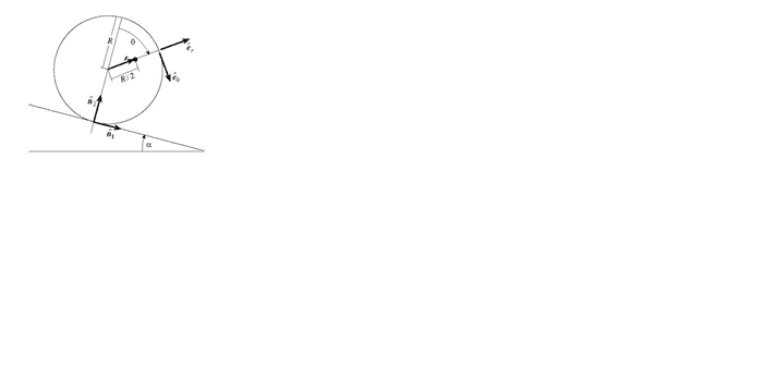

I'm trying to get the position vector of the offset mass relative to the inertial frame of reference. Do I account for the fact that the disk has rolled a little bit with respect to the inertial frame of reference? With that, I have
r,vector = d n1 + R n2 + R/2 er = R*theta n1 + R n2 + R/2 er,
where d = R*theta because the disk is assumed to roll without slip.
Or is it just r,vector = R n2 + R/2 er?
So, it's all a matter of where you define your origin to be. As drawn, [itex]\vec{r}[/itex] is with respect to the center of the disk. If the center of the disk is the origin, then [itex]\vec{r} = \frac{R}{2} \hat{e}_r[/itex].
If you say [itex]\vec{r} = R \hat{n}_2 + \frac{R}{2} \hat{e}_r[/itex], then you have defined your origin as the point of contact between the disk and the incline. Since the disk is accelerating, that origin is the origin of a non-inertial reference frame. Therefore, i don't think that's what you want since you say "relative to the inertial frame of reference".
I'm assuming that you mean the frame of reference of the incline (wherein the incline does not move), assuming, of course, that the incline is fixed in place by some means. Then, your first answer, [itex]\vec{r} = R \theta \hat{n}_1 + R \hat{n}_2 + \frac{R}{2} \hat{e}_r[/itex], is correct. Here, you have set your origin to be the point of contact between the incline and the disk when [itex]\theta = 0[/itex].
I'm guessing that you're already aware of this, but just be careful of the fact that while [itex]\hat{n}_1[/itex] and [itex]\hat{n}_2[/itex] are constant vectors, [itex]\hat{e}_e[/itex] and [itex]\hat{e}_{\theta}[/itex] are not; they change as the disk rolls down.

You are correct to say that you can't just apply [itex]F=ma[/itex] to the [itex]\{\hat{e}_r, \hat{e}_{\theta} \}[/itex] frame. You would have to take fictitious forces into account, which should be doable in principle, but not worth the trouble. However, you should be able to express these vectors in terms of [itex]\{ \hat{n}_1, \hat{n}_2 \}[/itex] since they span the same plane (the plane of the drawing). This relationship will be a function of [itex]\theta[/itex]. For example, when [itex]\theta = 0[/itex], you should have [itex]\hat{e}_{\theta} = \hat{n}_1[/itex] and [itex]\hat{e}_r = \hat{n}_2[/itex]. Once you've done that, then you'll have the position of the point mass just in terms of the constant vectors: [itex]\vec{r} = f_1 ( \theta ) \hat{n}_1 + f_2 ( \theta ) \hat{n}_2[/itex]. Of course, [itex]\theta[/itex] is a function of time, so [itex]\vec{a} = \ddot{\vec{r}} \neq 0[/itex].

Although F = ma cannot directly be applied to the E-frame, what fictitious forces must be taken into account to solve the problem? I know I can just rotate the E-frame into the inertial N-frame by a rotation matrix (or in this case, use er = sintheta n1 + costheta n2, etheta = costheta n1 - sintheta n2), and then use F = ma, but I'm curious as to what fictitious forces you would include to apply F = ma to the non-inertial E-frame.
I'm guessing the answer to my next question is no, but if the N-frame was moving (pure translation, no rotation) with the disc, so that its origin is always at the point of contact between the disc and the incline, would F = ma be applicable?
All the possible fictitious forces pertain to this problem, which is partly what makes going to the E-frame difficult. There is a linear fictitious force parallel to the incline just because the disk as a whole is accelerating down the incline. There are also the three rotational fictitious forces, Coriolis, Centrifugal, and Euler. In this case, I believe that Centrifugal points away from the center of the disk, Euler points up the incline, and Coriolis has both components, although I may be wrong here.
Roughly speaking, you know that some such fictitious forces must exist by the following argument. In the N frame, the resultant force on the point mass has at least a component pointing radially towards the center of the disk and another pointing down the incline. After all, it is rotating around the center of the disk and the whole disk is going down the incline. If you just naively transform these two components to the rotating frame, E, the result would certainly not be zero. But, the point mass is supposed to be at rest in the frame E! So the over-all fictitious force in the E-frame must have a component pointing away from the center of the disk and another pointing up the incline.
