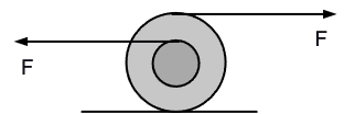

I am posting this to generate a parallel discussion to this ongoing thread. It seems that some participants in that thread have doubts and confusion about rolling motion that might be better addressed separately from the homework problem in question. It is a simple test of one's understanding of forces and torques and rolling motion and is meant for those who are seeking it. My hope is that their participation here by taking the test will help root out their misconceptions, preconceptions and misunderstandings. Of course, all are welcome to contribute.
Test takers: If you choose to answer (any of) the questions, please justify your choice(s). Justifications help diagnose trouble spots.
Statement of the problem
Two strings pull on a wheel of radius ##R## resting on a horizontal surface. The strings apply constant forces ##F## at ##R## and at ##R/2## in opposite directions as shown.
Case 1 The surface is frictionless.
1. In what direction is the acceleration of the center of the disk?
(A) To the left (B) To the right (C) No direction, the acceleration is zero.
2. In what direction does the disk spin/rotate?
(A) Clockwise (B) Counterclockwise. (C) The disk doesn't spin/rotate.
Case 2 There is friction at the surface but no slipping.
3. In what direction is the force of static friction?
(A) To the left (B) To the right (C) No direction, the force of static friction is zero.

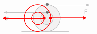

Case 1:
Q1 = A (Left)
Q2 = A (Clockwise)
The opposing forces generated by the two strings pulling in opposite directions (top one to right, bottom one to left) will act to maximize the horizontal distance between their two attachment points.
Since they're the same magnitude, the net effect is no movement on the centre of the two attachment points, but the wheel itself will be moved to the left:
* see sigline

Case 1:
1: C (acceleration zero, Newton's second)
2: A (Clockwise, it is a clockwise couple)
Case 2:
1: B (acceleration rightward. It is, at least momentarily, a simple lever pushing left on the ground. Newton's third says that the reaction force on the lever is rightward).
2: A (Clockwise, has to be in order for the no-slip condition to be upheld with the rightward acceleration)
3. Both directions. You didn't specify force on the wheel or force on the ground. But the force on the wheel is rightward (B) as already justified above.
Edit: I lose points because I made good choices but wrote down the wrong letters initially. [I'd expected choice B to be clockwise rotation to go along with choice B being rightward motion]

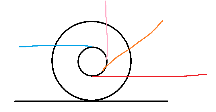

Orodruin said:
This is the type of question that would do well as conceptual questions in a flipped classroom situation. No calculations required and designed to test conceptual understanding.
I usually do this kind of discussion question for them, where the rope can be angled in various ways, how and will the spool roll and what happens to the chord if it will unwind or not
jbriggs444 said:
The spoiler tag accomplishes the "hidden post" type stuff.
[SPOILER]like so[/SPOILER]
like so
Yeah...next time I'll use that in the reply!
You might wish to try the trike trick. Loop a string around each pedal, and ask for predictions which way the trike will move when you pull (a) on the "pedal up" string (yellow arrow) and (b) on the "pedal down" string (red arrow).
Note: The handle bars will have to be constrained from turning about the vertical pivot.
(a) In the direction of the yellow arrow.
(b) In the direction of the red arrow.
The teaching comes when you ask, "then how come that when I sit on the trike and push on the 'down' pedal, the bike goes in reverse?"
