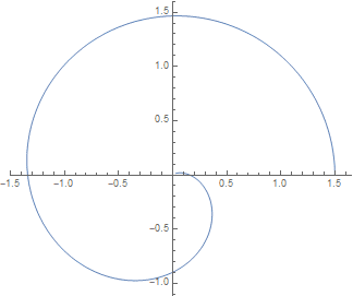

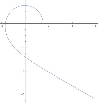

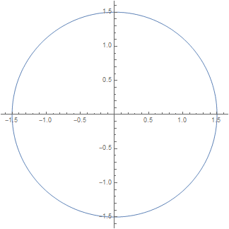

These two coupled differential equations are enough to numerically compute ##r(\ell) ## and ##\vp(\ell) ##. I used mathematica to try some concrete examples (setting ##r_s = 1## for simplicity). Let's start with the initial conditions for a light ray in orbit at the photon sphere. We can always set ##\vp(0) = 0 ## because it doesn't matter where our ##\vp## coordinate starts. We also set ##r(0) = 1.5## and ##r'(0) = 0##.
The light ray just goes in a circle, as expected. Orbits about the photon sphere are unstable, so slight perturbations will result in the light ray either being captured by the black hole or going off to infinity. Let's set ## r'(0) = 0.01 ##. In this case the light ray should escape to infinity because it is at the photon sphere with a positive radial velocity.
The equations seem to work properly. Now, one of the reasons I am making this post is because, interestingly enough, these equations that I've derived can apparently be used to trace light rays past the event horizon. Both of the differential equations are perectly well defined at ## r = r_s ##. If I set ## r'(0) = -0.01 ## we would expect the light ray to be captured by the black hole. Here is the result of that computation:
The light ray spirals into the origin and hits the singularity. Mathematica gives an error if you try to trace the light ray past the origin, which is to be expected.

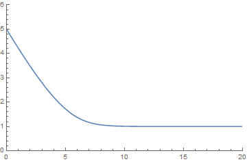

I think this is super interesting! I have tried numerically computing the light rays using both ## \lambda ## and ## t ## as parameters and, as I expected, light rays will not cross the event horizon at a finite parameter value. Here is a plot of ## r(\lambda) ## for a light ray emitted at ## r(0) = 5 ## traveling directly towards the origin:
As you can see, it approaches the event horizon but never crosses it. The plot for ## r(t) ## looks similar. But here is the plot for ## r(\ell) ##:
