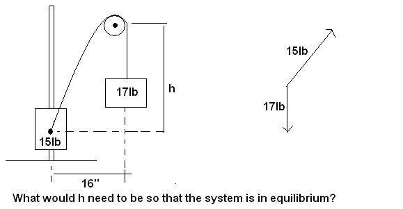

A 15lb weight at a on frictionless rod at a distance of 16" from a pulley can move up and down and it has counter-force on pulley of 17lb. What should the height of weight on rod be so that system is in equilibrium
Cosine Law
Sine Law
I have tried to draw the problem so that it would be better to understand. I'm not given any angles and not sure to get started here.
  • Diagram of a 15 lb block on a vertical rod connected by a cord over a pulley to a hanging 17 lb block, with h marked as the vertical distance and 16 inches horizontal, beside a force triangle with 15 lb and 17 lb sides.
What's the tension in the pulley cable? What angle must the cable make with respect to the weight on the rod. (Redo your force diagram to show the forces acting on the 15lb weight.)
I'm having difficulty trying to understand the problem as is. The tension in the cable would be the sum of all components of both weights, but I'm not given angles to find them. Wouldn't the tension be 32lb anyways?
No, that's not true.
No.
To find the tension in the cable, analyze the forces acting on the 17lb mass. That mass must be in equilibrium also.
