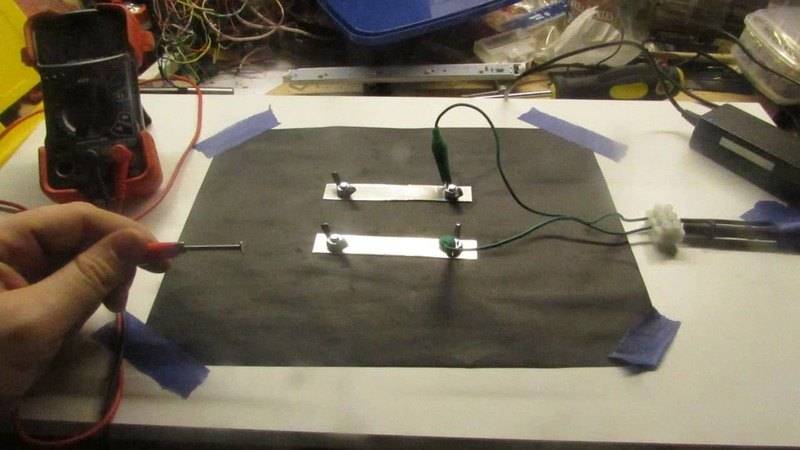

Well, here is my prototype. The problem I am having with the carbon paper is that the reading fluctuates to the point of being unusable. In the pic it shows a nail head I was using, but I tried various things like small copper squares, galvanized cylinders, etc. It might be more usable with a analog multimeter. The bars are aluminum, and hardware is galvanized. The bars are tightly compressed against the carbon paper. The voltage source is an ancient laptop charger rated at 12 V and 3A. Readings of resistance on the paper with probes roughly 1 cm apart are upwards of 22 Mohms.
As far as what I'm shooting for, I would like for high school students who know nothing about vector calculus to be able to sketch equipotential maps from real fields in real space. Afterwards, they could compare their plots to theoretical constructions I prepare with Mathematica. So it can be crude and inaccurate as long as the general shapes are there. I was hoping they might be able to drag around the probe and see how the reading does not change on an equipotential. As mentioned though, its unusable due to sporadic readings.
Your multimeter might draw too much current for a reliable measurement. Do you know its resistance?
My multimeter is 10 Mohm.
Then it will influence the measurement significantly. You can use it in zero-current-mode (compare to a fixed voltage at the other lead) to find equipotential lines, but getting a sheet with better conductivity is probably easier.

For zero-current-mode, do you mean putting one probe on + and the other on the paper?
Would a cheap 5-10 dollar analog multimeter have a lower resistance?
Put the other probe to the potential where you want to measure the equipotential line. Can be externally, can be on the sheet itself.
10 MOhm is not bad for a multimeter, getting a better one is probably more expensive than buying the paper discussed above.

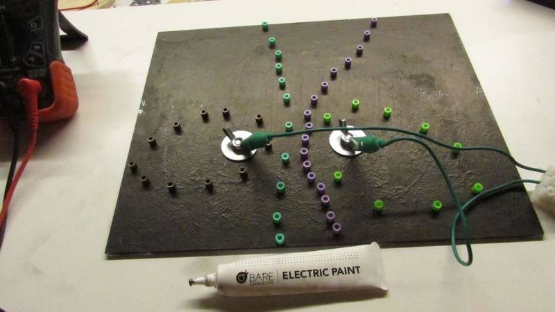

I seem to be in business. Turns out I had some conductive paint kicking around. Decided to spread it out on a piece of acrylic, and cut holes for the conductors. The readings were completely steady with one lead at 0 and the other tapping the surface. I found some of my wife's ironing beads and was able to slip the bead onto the probe and scan around the surface. When I reached the voltage I was looking for, I lifted the probe. Here is an example with brown 10 V, turquiose 7V, purple 5 V and green 3 V. The left conductor is 12.3 V and the right is 0.
This is obviously more expensive than getting the teledeltos paper, but I had these things on hand and it seems very durable.
