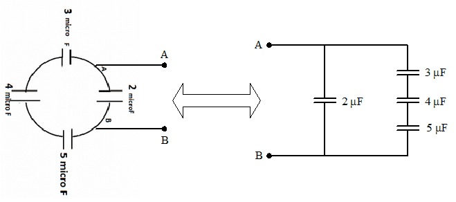

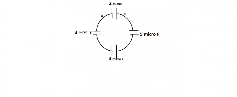

Find the equivalent capacitance between A and B.
I think all the Capacitors are in series but according to my book only three capacitors are in series.How?
When the problem named and labelled the two nodes A and B between which you are to determine the capacitance, it effectively implied connection terminals for the circuit. These terminals provide a favored point of view for you to interpret the circuit.
Likes gracy
How did you switch from one figure to the other,wire A and wire B seems flipped and how you decided that 2 μF location?
Your original figure is just rotated to bring the terminal leads horizontal. The two circuits are mirrored about the center where the arrow is. Follow outwards from the center and confirm that you find the corresponding components in the same (mirrored) locations.

That's not important ... the point is the circular and square arrangements are the same circuit layouts
and it is now easier to visualise and to solve the problem
so now have a go at solving the total capacitance value between points A and BDave
Mirrors reverse front to back, not top to bottom. Otherwise you'd be looking at your feet in the mirror rather than your eyes :smile:
Surely you can see the symmetry between the two circuits? Confirm that all the components of both circuits make the same connections to each other.

You're asked the capacitance between A and B. What is there between A and B? One way there is one capacitor, the other way there are three capacitors in series. No big deal to alternatively draw them as in #2.

But why gneill rotated my diagram in OP 90 degrees to the right?
It does not matter. I guess, you have a necklace. Is it the same necklace if you rotate it, turn it over, make the threads differently curved, fold it? Throw it up into the air, or hold it in your hand or around your neck?
People working with electric circuits like to draw the terminal points vertically, one below the other.
Likes gracy
Why do you care? You are obsessing on things that do not matter, and doing that is interfering with your ability to learn and understand!. All that matters is the "topology", not the shape or the orientation.
