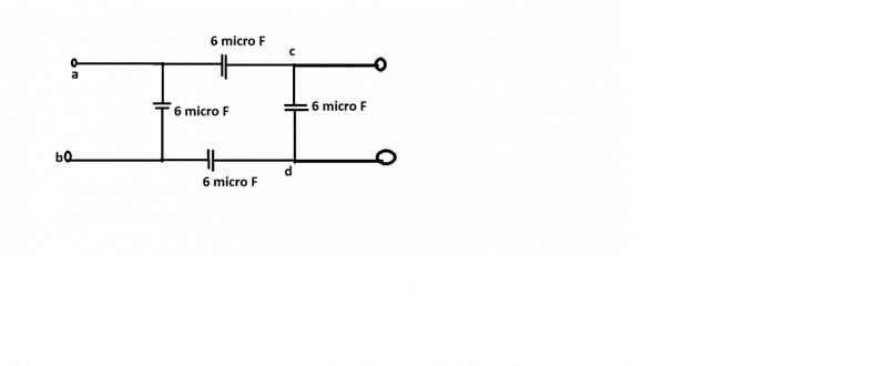

If 100 volts of potential difference is applied between a and b in the circuit .Find the potential difference between c and d.
There are terminals a and b and now we have to find potential of c and d hence we have to fix terminals in there so now should i proceed with 2 pairs of potential terminals?
Terminals a and b were added because the original problem statement wanted you to consider the equivalent capacitance as viewed across the labeled nodes. The added terminals just make the situation obvious.
You have formulated a new problem where, given an applied potential difference across ab, you wish to find the resulting potential difference across nodes c and d. In this case c and d are just nodes that you don't plan on doing anything with except perhaps measure their potentials. There are no special procedures required. Labeling these nodes doesn't alter the circuit or impose any new conditions.
gracy said:
Should not I fix terminals at c and d?like this
You can if you want to. It doesn't change the circuit operation in any way if you don't connect anything to the new terminals. Open terminals won't pass any current.
don't connect anything means?not even voltage source?
gracy said:
I think it provides a point of connection to external circuits.So there should be some supplied voltage.
Not necessarily. You don't have to connect anything if you don't want to. Sometimes terminals are just provided for test points to make it convenient to connect test equipment like voltmeters.
Unless you connect something to a circuit it doesn't affect the circuit.
In many instances "output terminals" are drawn in order to draw your attention to where you should consider the circuit output to be. They don't affect the operation of the circuit just by being there.

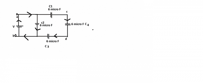

In this question I should apply voltage i.e 100 volts in between A and B but no voltage in between C AND D Because it would be wrong.Right?
Like this!(sorry capacitor and voltage source symbols look alike)
Here C1 and C2 are not in series ,right?
Right.
Is current direction correct?
From positive terminal of battery to the rest of the circuit.
Right. It would be wrong for the problem that you posed to apply another source between C and D. It would change the circuit and create a different problem.
gracy said:
please answer my #46
That's right too. Here, 100V is input and Vcd is the output voltage.
Your indicated currents look fine for the instant that the circuit is first assembled. Since there are no resistances in the circuit it will reach steady-state essentially instantaneously though, and all current flow will cease leaving the capacitors with some charge values.
