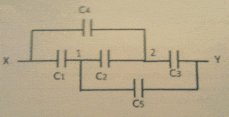

I'm having a time figuring out how to solve this one, hope someone can help me out
"Calculate the equivalent capacitance between X and Y on the circuit in the figure. C1=C3=C4=C5=8uF, C2=20uF"
I can't figure out a reduced circuit straight away. I tried to see what will be current at the ends of each capacitor and each of them as different ones so I can't consider any of them to be in parallel.
Sometimes redrawing the circuit can help you to visualize a solution. Try moving terminal X to the top (centered over C2) and terminal Y to the bottom (centered below C2). Nodes 1 and 2 remain where they are.
I simplified the circuit for you here. Hope this helps!
Considering the symmetry of the network, what can you say about the ratio of potentials at nodes 1 and 2 if you "ground" Y (define V_Y = 0) and apply sinusoidal voltage V to X ?
Use that simplification to compute I = jwCV where I is the current from the source V and C is your equivalent capacitance.

Thank you very much for your answers! I feel so stupid for not being able to redraw the circuit myself :P
OK, so this is a "Wheatstone Bridge". The more you know...
Now since C1/C5=C4/C3 the voltage at points 1 and 2 (both sides of C2) is equivalent, thus there is not current flowing through C2 and I can just ignore it. Then I end up with C1 and C5 on one side (1/Ceq_a=1/C1+1/C5) and C4 and C3 on the other (1/Ceq_b=1/C4+1/C3) and the total Ceq=Ceq_a+Ceq_b.

There you go! :approve:
Actually you have a choice of methods. Since those two potentials are equal you can either remove the capacitor C2 or replace it with a short. No current will flow in either case :wink:

The original "Wheatstone" bridge was resistive, but the concept of bridge circuits has expanded to cover circuits with reactive arms. The idea of a balance point where no current flows in the bridge is common. And as gneil says, it may therefore be replaced by open or short for that condition.
There is no "proper" method. You just use what you know about the circuit to help in whatever way you choose.
It may not be quite correct to call it a Wheatstone bridge, but I don't think anyone would be misled or fail to understand if you did. The principle is the same.
