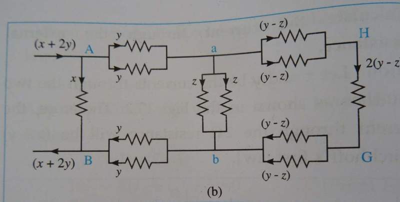

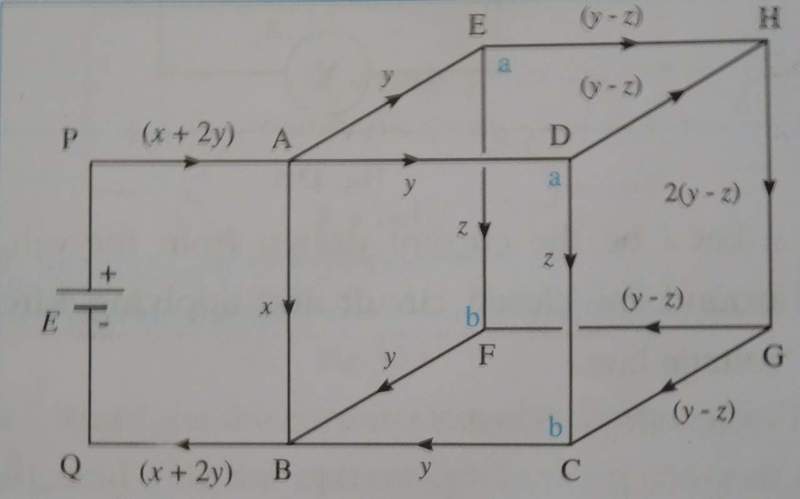

Here is a cube of resistors with each resistance of value "R".Find the equivalent resistance between A and B.
My book says the equivalent circuit of the cube is :
But i don't think it is correct.They have made parallel combinations which don't seem right.Is the book correct??

you need to make your figures smaller. They are HUGE.
I agree w/ you that it doesn't seem correct but I'm guessing they are using some trick of symmetry in the redrawing.
The plane through the points ABGH is a symmetry plane, so the potentials of the points D and E must be equal, so you can connect them with a wire. Same for the points C and F.

O,thanks a lot :smile:

I realize this is a decade old thread but I checked it and it is correct.
