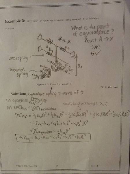

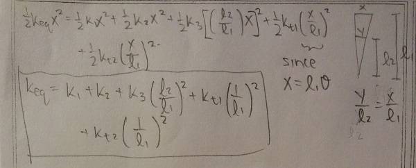

Equivalent spring constant of a system
theBEAST
361
and the attempt at a solution[/B]
I tried to find the equivalent sprint constant using two points of equivalence. The first is with respect to theta. The second is with respect to the datum x as shown in the images below. The two methods yield two different answers which is not what I expected. Did I do something wrong?
