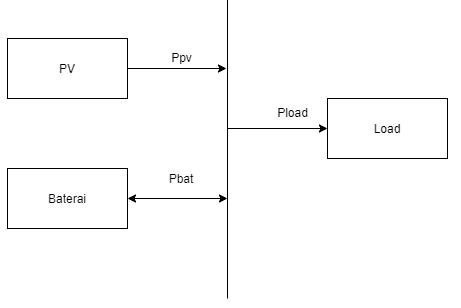

A description of my problem:
I want to simulate a microgrid using 4DIAC Forte. I have 3 block functions: PV,Battery, and Load. Now, I want to combine these block functions to simulate the microgrid.
1. PV Block function
#input : temperature & solar iradiation value
# output : PV voltage, PV current, and PV power
2. Battery Block Function
#input: Charge/ discharge current
#equation
#output: Battery voltage
3. Load function
#input:resistance
#output:Load power/ consumed power
In order to combine these 3 block functions, I use this equation:
##I_b##= battery charge/discharge current
##P_{supply}=P_{pv}+P_{battery}##
##P_{demand}=P_{load}##
##E_b##=battery voltage
I have validated the PV model and the battery against the datasheet. Both are valid. But I get an error when I combine these block function using the equation above. The error occurred when ##E_b## value is close to 0.

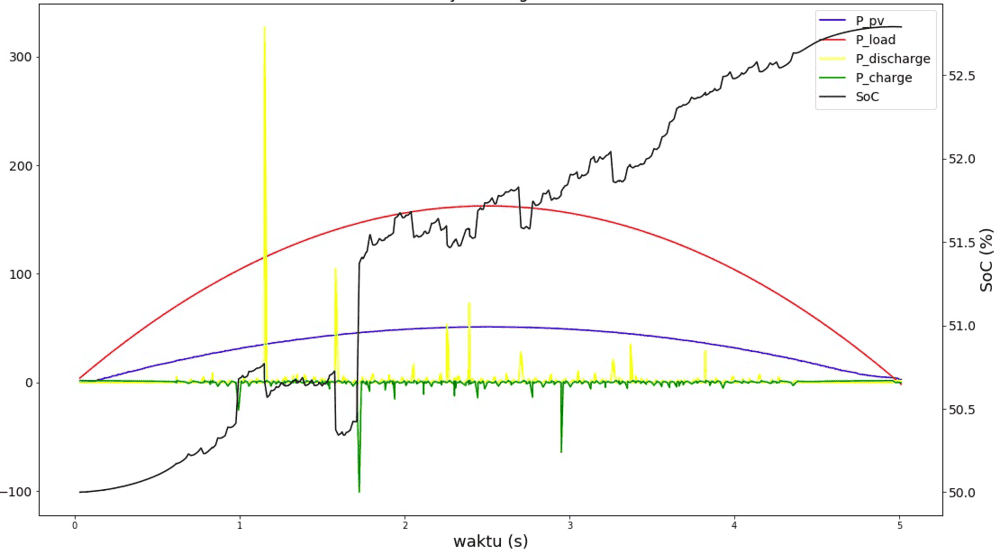

This is the example of my simulation result.
The x-axis is time. The left-y-axis is power. The right-y-axis is battery's SoC.
There are significant errors in ##0<t<2 seconds##.
How can your battery charge up if the load needs more power than the solar cell provides? How can P_charge jump so erratically when the inputs don't change? There are some odd features here.
Yes, there is something wrong, but I am still looking for a solution.
May I ask for advice, where should I start to fix this? Thank you
Some general approaches for debugging:
  • Simplify by eliminating some stuff
    • Try without a load and a fixed value for P_pv
      • Does the battery stop charging at the correct Voltage? State-of-Charge (SoC)?
        If not, the model of the PV panel and/or the battery is/are wrong.
    • Try P_pv=0, battery SoC=100% and fixed load (Battery SoC should drop faster as time progresses, especially the first and last 5%)
      • Does the load stop drawing power when battery SoC is approaching dead? Does SoC ever go negative?
        If not, the model of the battery and/or the load is/are wrong.
  • Pick some variables that can be fixed and make them a constant for a run
    • P_pv and P_load would be good candidates to be steady and equal to each other
  • Run them and see if the results are reasonable
    • If not, print the internal variables in the internal loop(s) before, during, and after the time that gives bad results. (Hard copy to a printer is MUCH easier to cross-check with. You can lay many sheets out on a desk, the floor, or a wall and easily do multi-way comparisons. Be sure that each sheet notes any program changes and any fixed/initial values of variables. Otherwise you lose track after about 3 iterations!)
A few of notes:
  • Constant power loads are not very common. Most have a resistive component such that power is directly proportional to Voltage.
    • This includes batteries which over much of their range have a super-linear decrease in output voltage with SoC,
  • The integration step of 10-4 over 10 sec. is a prime suspect for problems. You may find that with the internal representation of numbers in the computer, that adding a small value to a large value does not yield the expected result.
    • A possible work-around is to increase the time step, perhaps to 10-2 or 10-1 sec. If you must handle fast transients, then calculate an average value within each integration step with the needed resolution.
Well, that should keep you busy for awhile... and it's late, I'm falling asleep.😴
