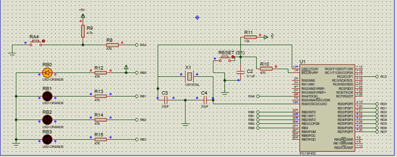

PLease help, I am fairly new to proteus and mplabx so I am trying to udnerstand how it all works. I am using PIC18F452 microcontroller.
I have this circuit in proteus shown at the bottom of the text.

When Switch RA4 is pressed, the system flashes the 2nd and 3rd LEDs intermittently.
RA4 is the activate/deactivate switch as i understand, but since I changed it to RD4, as well as the settings that involve PORT/TRIS/LAT A to PORT/TRIS/LAT D, the LEDs keep flashing and the switch stops working. How do I fix that?
It's also requested that my RESET switch is connected to RC4, not sure how that works either as I am aware the MCLR pin is the one that resets the MCU? How can the RC4 pin reset the system?
Final issue, the first LED should only be on when the system is on, but if the power terminal isn't pesent they won't turn on at all..
Appreciate your help a real lot!
