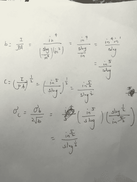

given E is constant, find the uncertainty in the angular frequency, ω.
can someone please check my work?

I don't think your expression for σc in the third line is correct. You can check using dimensional analysis.
Likes EastWindBreaks
thank you, does this looks correct? σc = σb / (2sqrt(b))
I checked. it seems ok?
Yes.
