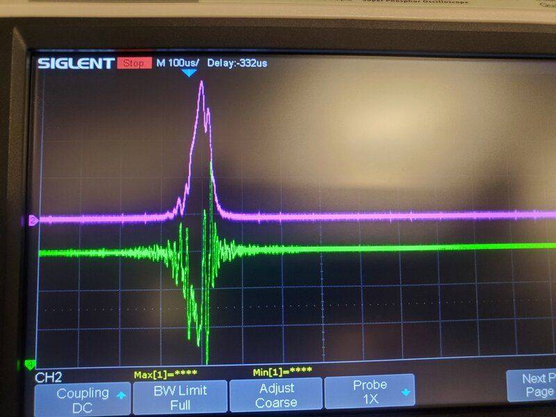

Thank you for the reply again! Isn't the formula for the linewidth: ##\frac{c}{FL}##, where F is the finesse and L the cavity length (about 1 meter in my case). So I would get ##\frac{3\times 10^8}{10^4} = 3\times 10^4 ## i.e. 30 kHz?
Do you know the modulation port's scaling factor for your diode laser? Multiply that number by 20V (output voltage range of the D2-125 lockbox) and that's your servo's locking range (but if your laser controller has a smaller input voltage range than the D2-125's +/-10V, use that voltage instead). I would look at your transmission peak while scanning and see what the typical range of frequency noise is. How does that frequency noise compare to the locking range?
The laser changes by 100 MHz per applied V. Is that what you mean by scaling factor? My laser can only accept between -4 and 4 V as input so I am using a voltage divider (when using the Vescent servo) and I am usually only applying between -3 and 3 V, so I am covering at most 600 MHz (but usually I do much lower, just to see one peak per ramp). What exactly do you mean by frequency noise? The peak sometimes moves left and right quite a lot (more than 100 MHz), probably due to mechanical vibration (as that motion is quite slow). Do you mean some noise on top of that?
EDIT: I will have to look around for a microscope, but I did clean the mirrors in the past without a visible change in the linewidth. I also completely changed the mirrors from 0.5 to 1 inch (I thought it might be some diffraction losses issue) and I got similar results, so I doubt the linewidth issue (assuming I did the math right) is from the cleanliness of the mirrors (at least not only from that).
That's exactly what I meant by frequency noise: side-to-side motion of the transmission peak when you scan the laser.
That's quite a lot. Sorry if you mentioned this before now. This thread's gotten a little long and it's hard to remember everything.

Looking back at post #11 again, I noticed the timescale of your noise events is really fast (roughly 10 microseconds), so I think you're right. This is way too fast to be environmental fluctuations. Sorry for not noticing that sooner.
The problem could very well be electronic noise. After all, with the humongous 100MHz/V scaling factor on the laser modulation port, it only takes 10mV to push you off a 1MHz line (if you line is actually 30kHz, then it only takes a mere 300 microvolts). Because electronic noise can be very fast, it's possible that your servo can't keep up. I'm curious what will happen if you engage the differentiator on your D2-125 and set the corner frequency to about 10kHz or 20kHz or somewhere around there. Alternatively, you could try adding a 10 or 20kHz lowpass filter between your photodiode and your servo. (Using the battery-powered photodiode was a good choice!). Another possibility is that the origin of your noise could be from ground loops (remember, your oscilloscope is a connection to ground).
If it's not electronic, then it could be vibrations in the upper audio band. Does your lock get messed up if you start talking or clapping your hands near the cavity?
The differentiator should help regardless if the noise is electronic or vibrational. But the lowpass filter should only help if the noise is electronic and from your photodiode.

Post #29 indicates around 20kHz, well within the range of electronic ballasts in common LED and Fluorescent lamps, switching power supplies, etc.
kelly0303 said:
these peaks seems to come and go every 50 ##\mu s## or so.
That reminds me, some switching power supplies are terrible for leaking switching noise, both conductive to the output and radiative.

I tried the clapping, and the lock is stable still. Thank you for the suggestion with the electronic noise. However I just placed a piezo mirror, such that I am now forcing the cavity to follow the frequency of the stable laser and I am getting exactly the same result (regardless of the differential value, or the servo used). I really don't know what to do and also I am confused by the fact that no one (and I talked to quite a few people with experience in cavities) seems to have seen this before, given that I am using mostly commercial components that most people have also used. It's so unlikely that no one has ever seen this behavior before.
Just to clarify, you engaged the differentiator, and the result was that the error still remained just as noisy and the transmitted power did not increase? That's really bizarre. Did you try the lowpass filter on the photodiode?

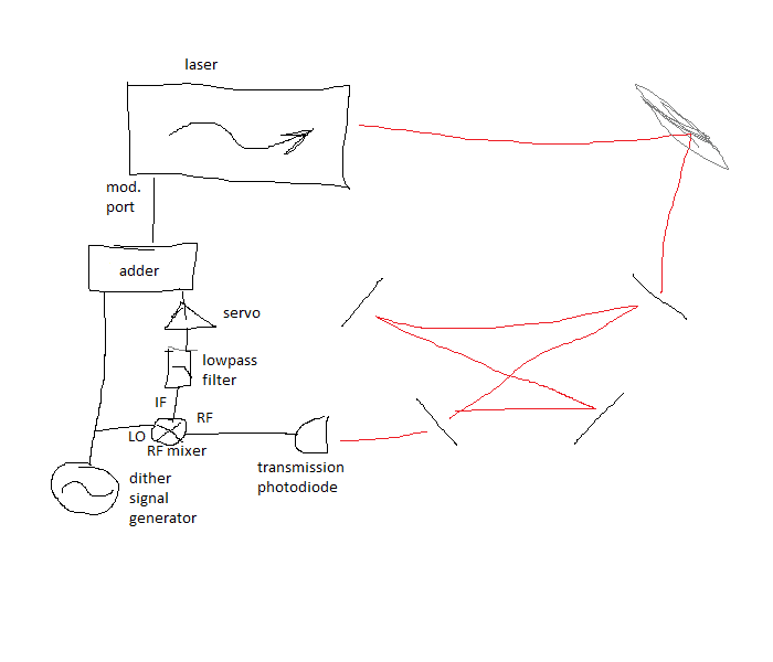

I just got a reply from the laser company:
For side of fringe locking wo/modulation you assumed that the AM error signal (between transmitted and fixed reference ) is linear (at 50 % transmission point) and proportional to a frequency fluctuations ~dn. Such assumption is prone to errors caused by the intensity fluctuations which are interpreted as frequency fluctuations. Usually to correct such crosstalk with DFB or DBR lasers it is necessary to use LF dither frequency with small amplitude Dn << fringe LW and use a lock-in detection. Your fringe has a very narrow LW which makes this approach (wo/intensity monitor) even more sensitive to the intensity noise
And then basically they mention that changing the laser frequency induces a change in power which would affect a side of fringe lock. I don't really understand everything they suggested above (I will need to do some google about the technical terms), but if anyone here can give me a dumbed down version I would really appreciate.
However, while I agree that while scanning the frequency over 300 MHz (the FSR of the cavity), the power might change, when I am locked, the frequency shouldn't need to change by more than a few kHz. Can it really be that such a small freq change lead to a power change big enough to mess up my lock?
What they're suggesting is that your servo is trying to control the laser frequency but ends up getting confused by fluctuations in the laser output power.
For example, if your servo locks when the transmission photodiode reads 1V, but then your laser power drops to 80%, then your transmission photodiode will read 0.8V (so your error signal will be -0.2V), and the servo will compensate (even though the laser frequency had not changed).
What they suggest is to stop side-locking your laser and switch to a lock-in scheme. I drew a quick sketch below.
Hand-drawn block diagram of a laser cavity lock: laser with mod. port feeding an adder, a dither signal generator and RF mixer with lowpass filter and servo, and a transmission photodiode feeding back, with red beam paths through mirrors and a cavity.
The key here is that your error signal lockpoint will become independent of laser power. If you want a mathematical argument for why this is, I would recommend reading about the math behind PDH locking. The main difference between the above scheme and PDH locking is that this scheme uses the transmission photodiode (PDH typically uses reflection photodiode, for higher bandwidth) and the strength of the modulating signal.
As far as jargon, "dither" usually means a small amount of frequency modulation used to generate the error signal, and "lock-in detection" likely means using the demodulated photodiode signal instead of the DC photodiode signal as your error signal. Were there other terms that were confusing?
P.S. It only just occurred to me that because you've been locking with the transmission photodiode, your servo never had a chance of dealing with the high frequency noise on your error signal. The transmitted power out of the cavity is band-limited by the cavity linewidth, so if your linewidth is 30kHz, you will never be able to stabilize noise faster than 30kHz while locking to the transmission photodiode. If you want to go faster than that, you need to use the reflection signal (which is not limited by the cavity linewidth). Sorry it took me so long to put that together!
Edit: If you're looking for a good place to learn about PDH locking, I suggest Holger Mueller's "Electronics for Pros" lecture #18, see here.
Edit edit: Actually, I'm not sure if the reflection signal on a bowtie cavity is bandlimited by the linewidth or not (it definitely is not limited for Fabry-Perot cavities, but I don't know about bowtie cavities). I added strikethrough to my comments where I made this claim. Sorry!

Thanks a lot for the explanation and the link, that is really helpful! Trying to lock to the reflected signal is a great idea, I will try it on Monday!

Thank you for this! So what are the small oscillations on top of the main peak? Are they expected from the fact that the frequency changes in time?
About scanning my cavity, I am currently scanning the mirror piezo at 100 Hz. I could go lower but from my past experience the peaks start behaving crazy if I go below that. I am attaching below a peak (this is actually a nice looking one compared to what I see) obtained when scanning the cavity at 10 Hz. I also suspect that at this frequency I might have some issues with mechanical vibrations? Definitely the peaks start to move left and right and change their amplitude a lot more compared to when I was scanning at 100 Hz or higher, and actually I start seeing each individual "peak" made of lots of peaks as if the peak moves left and right, while I scan over it.
  • Oscilloscope screen, Siglent, showing a purple trace with a single tall central peak and a smaller green trace below with a bipolar oscillating pulse around the same time point.
When you scan the laser with a scan rate of 10Hz, what is the range of the scan? What I really need is the frequency-per-second scan rate. For example, in post #50, it was ##300\mathrm{kHz}## in ##20\mathrm{\mu s}##, or ##15\mathrm{kHz / \mu s}##. What was this rate in the data in post #52?
For the last figure I sent, I didn't change the voltage range, just the frequency, so the speed should be 10 times smaller than before, so that would be ##1.5 kHz/\mu s##
Probably fluctuations either in the laser frequency or in your cavity's optical path length. It's impossible to discriminate between the two of them with the tools at your disposal. There are tricks you could try if you had two lasers (or equivalently, a fiber EOM phase modulator for frequency-offset-locking).
I don't think so. Take a look at this paper for the full theory. It's written for Fabry-Perot cavities, but I think it's the same except the "round trip time" is ##\tau = L/c## for a bowtie cavity. I did the math for the data in post #52 and I get a ##v_\omega## of 10.6. As you can see in Figure 4d, there really shouldn't be any oscillations due to the laser scan.
However, if your cavity mirrors were contaminated with dirt causing you to have a broadened linewidth, then anything is possible. I don't really understand the transient dynamics in this regime, but they're noisy and annoying.
At 10Hz, that's very possible. Again, there isn't a good way to distinguish between laser fluctuations and cavity fluctuations when you only have the one laser and the one cavity.
Could you try turning the frequency back up to 100Hz and turn the voltage range down by a factor of 10x? Are the results the same? It might give some indication of the frequency-dependence of your oscillations.
Twigg said:
Probably fluctuations either in the laser frequency or in your cavity's optical path length. It's impossible to discriminate between the two of them with the tools at your disposal. There are tricks you could try if you had two lasers (or equivalently, a fiber EOM phase modulator for frequency-offset-locking).I don't think so. Take a look at this paper for the full theory. It's written for Fabry-Perot cavities, but I think it's the same except the "round trip time" is ##\tau = L/c## for a bowtie cavity. I did the math for the data in post #52 and I get a ##v_\omega## of 10.6. As you can see in Figure 4d, there really shouldn't be any oscillations due to the laser scan.
However, if your cavity mirrors were contaminated with dirt causing you to have a broadened linewidth, then anything is possible. I don't really understand the transient dynamics in this regime, but they're noisy and annoying.At 10Hz, that's very possible. Again, there isn't a good way to distinguish between laser fluctuations and cavity fluctuations when you only have the one laser and the one cavity.Could you try turning the frequency back up to 100Hz and turn the voltage range down by a factor of 10x? Are the results the same? It might give some indication of the frequency-dependence of your oscillations.
I will check the effect of reducing the range tomorrow (I think I tried and didn't see a major difference).
Sorry I wasn't clear with the "So what are the small oscillations on top of the main peak?" question. This was meant for the figure the laser company sent. I understand that I get a broadened peak, because the 2 laser don't have a constant frequency difference, but what are the small oscillations on top of that peak?
