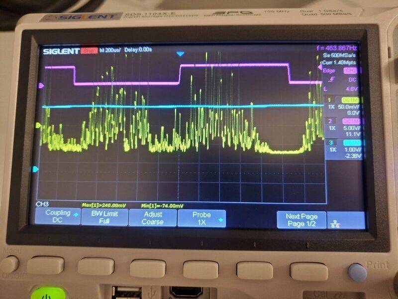

Hello! I am trying to lock a laser to a bow-tie cavity. I managed to align the cavity to a certain degree but when I lock it, the error signal looks as below. I do get a significant power enhancement (although about 10 times smaller than expected) and the lock is relatively stable, but the error signal looks nothing like what I would expect. I imagined it to be a flat-ish line, maybe moving up and down around zero, suggesting that the lock is decently good. But I am getting this signal with lots of peaks (again this is after I turn the lock on, not during the scan of the cavity). Has anyone seen this before? What should I do to get a well behaved error signal.

First, a jargon thing: by error signal you mean the input to your locking servo, correct? Some people I know call the output of servo the error signal, and it gets confusing. (For the sake of clarity, I always call the output of the servo the "control signal."
Also, what's the vertical scale on that scope trace? I can't tell if those are 1mV peaks or 1V peaks.
If this is indeed the input to your servo, then you need to tune the gains on your servo. Here's how I do it:

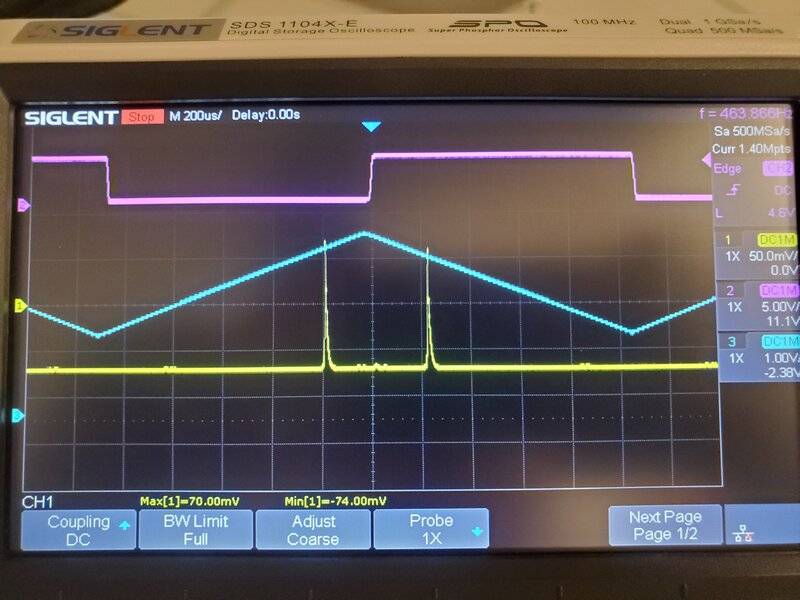

@Twigg I am attaching below some pics.
The first one show the scope screen in ramping more. The yellow is the signal from the photodiode, blue is the ramp itself and pink is the TTL ramp. The scale of the yellow is 50 mV (after placing a ND 1.0 filter on the photodiode) and the scale of blue is 1V.

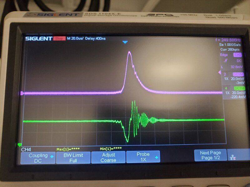

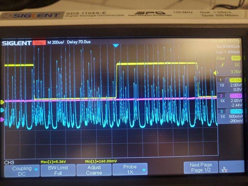

The second one shows what happens right after I turn on the locking (without changing anything on the oscilloscope). The error signal (blue) is flat and has small oscillations, however it doesn't jump to the maximum voltage (that actually happens when the lock is lost i.e. when I don't measure a lot of power on the power meter anymore), but the input signal still has many peaks (they are now actually narrower than before as I aligned the cavity a bit better today).

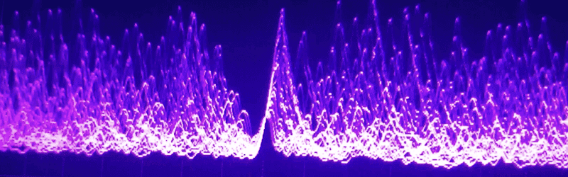

Figure 3 and 4 show the beam spot measured on a CCD camera before and after the lock. The camera is definitely saturated, but a clear enhancement can be seen (on top of the one measured by the power meter).

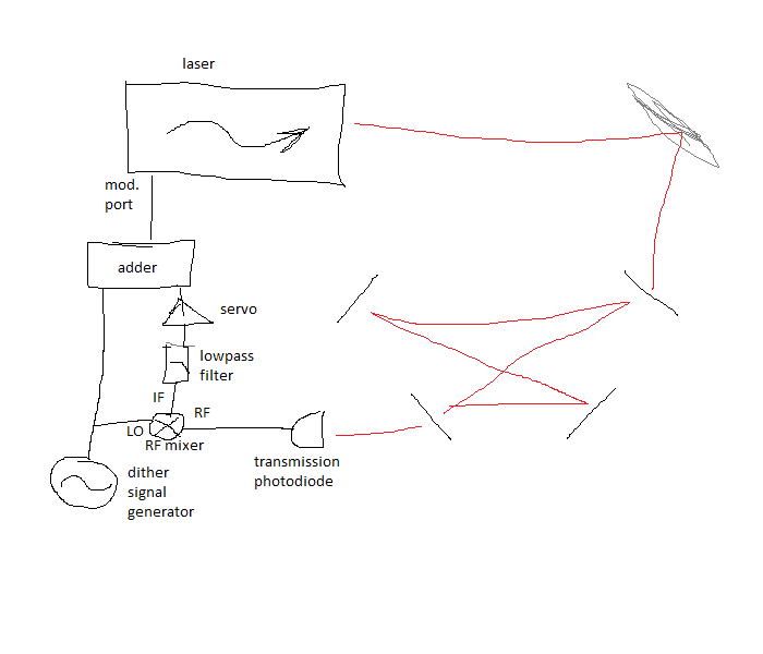

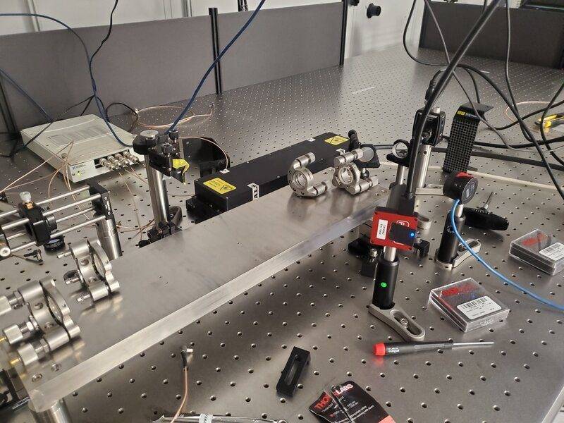

I am also attaching my cavity setup. It's pretty straightforward. I am measuring everything (diode, power meter and CCD camera) in transmission mode.
Thanks a lot again for help and please let me know if I should provide more information.20221019_200445.jpg20221019_200538.jpg20221019_200904.jpg20221019_200921.jpg20221019_200838.jpg

Ok, you are most certainly locked.
There is definitely something wrong, as your transmission signal seems to fluctuate all the way to 0 while you are locked.
I am confused about the error signal trace (blue, in pic #2 of post #11) you sent. Shouldn't the error signal (blue trace) be the same as the transmission photodiode (yellow trace)? Or is the blue trace supposed to be the servo output (labeled "Servo Out" on the Vescent servo)? Sorry for doubting you, it's just really confusing why the yellow and blue don't look the same.
Can you elaborate the connections to and from the Vescent servo? Am I right that you connect the transmission photodiode into the "Error Input" port (bottom left of the front panel). Which of the ports is the blue trace?

The blue line is indeed coming from "Servo Out" (I thought this is what you meant by "control signal").
In terms of the Vescent connections, it is like this: the photodiode signal goes to "Error Input". The "DC Error" output is the yellow line. The "Servo Out" is the blue line. The "Servo Output" goes to the laser. The "Ramp TTL" is the pink output.

Does the noise on the error signal get bigger or smaller when you increase the P gain (using the coarse gain knob)?
It bugs me that your servo doesn't even try to keep up with the noise on your error signal. That is strange. It could be that your high-frequency gain is too low (seems unlikely, but possible). To solve this, you could increase the corner frequencies for your first and/or second stage integrators (the knobs on the side of the Vescent box).

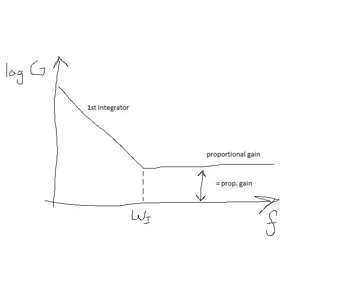

The way you're supposed to fine-tune the second integrator and differentiator is to hook up your error signal to a oscilloscope or network analyzer and display the Fourier transform of your error signal. The amplitude of the Fourier transform indicates the magnitude of instability in your laser as a function of frequency. For example, if you used a PZT to modulate your laser at 10Hz, you would see a large peak in the FT of the error signal at 10Hz. If your laser drifts a lot due to thermal effects, you would expect to see a large component of your error signal FT at low frequencies (since thermal effects are slow), often following a 1/f dependence on frequency. To fine tune the D2-125 servo's many settings, you would adjust them until you make the FT of the error signal as small as possible over as large a frequency range as possible.
Look at the graph on the side of the D2-125 box. This shows the gain of the Vescent servo as a function of the Fourier frequency. When you adjust, for example, the first integrator knob on the side of the lockbox, you are moving the corner frequency labeled ##\omega_I##. Likewise for ##\omega_{PI}## (2nd integrator) and ##\omega_D## (differentiator). Controlling the frequency of these corners allows you to distribute the gain of the servo over low- and high-frequency bands to best match the specifics of your laser noise spectrum. So you adjust the various settings until you optimize the FT of your error signal.

So when you turn the 2nd integrator off, you're not setting the corner to 0, you're removing that feature from the gain plot entirely. So if you turn off the 2nd integrator and the differentiator, what you have is a typical PI gain curve:
Edit: Whoops, I forgot to respond to your second question.
Ok, so if I understand you correctly, then (1) as you turn up the P gain the noise gets smaller and (2) as you turn up the P gain the output power increases to a maximum value and then gets smaller if you increase the P gain any further than that. However, even when you turn the P gain so high that your transmitted power gets smaller, your error signal noise still gets smaller? That part is very confusing to me.
If you put the P gain to the point where the transmitted power is maximum, what happens if you increase the first integrator gain?
Edit: In the sketch I drew, the x-axis should also be logarithmic scale (log f). My bad

@Twigg sorry for the delayed reply. Actually as I turn up the P gain the noise get smaller, but the power gets smaller, too, it doesn't increase to a maximum. The maxium power is where the P-gain knob is at one of the lowest values (not the lowest, tho, as it loses lock there), if I increase it from there the noise is a bit reduced but the power, too.
Based on some of your suggestions I also replaced the damped legs with normal ones, such that the laser and the cavity feel the same vibrations and nothing changed. I also replaced one of the mirrors I am using (Layertech) with a Thorlabs one, with lower reflectivity, in the hope that maybe the issue is that the cavity linewidth is too narrow and this would make it bigger, but I got the same effect (but of course with much lower power output).
I am thinking to reduce the cavity length by a bit (it is about 1.2 meters long now) and see if things get better. Intuitively i expect that a small change in one of the mirrors would have a big impact on the alignment given that the cavity is not stabilized and so long, but I was hoping the servo would be able to solve that during lock.
To be honest everyone in my lab and even the technical support from Vescent told me they have never seen this effect before so I am kinda out of ideas as to what can cause it. Just for reference I am trying to do something similar to this. I don't need a beam spot size as big as theirs (2-3 mm is enough for me), I even went quite far from the stability edge just to see if things get better (they don't!) but even so I can't seem to make it work. On top of that they claim in the paper that in the bow tie setup with 2 curved and 2 flat mirrors (which is my setup, too), the system is quite insensitive to vibrations, and straightforward to lock, which is kinda frustrating give my experience with this cavity. Anyways, any further insight would be greatly apprecaited.

Does the behavior of the Vescent lock change if you change the incident optical power? Maybe it's a thermal effect of the cavity?
@Twigg @DaveE Thank you for your replies. I actually tried this servo, too, but with this one I was not able to get a lock at all (not even the one I got with Vescent where I see a significantly brighter spot, despite the power output looking so weird). I still haven't figured out what the issue is with this second servo. I don't think we have a second 1064 stabilized laser, but I will try to adjust the power more and see what happens. However the power I am using now is about 50 times smaller than what I aim to use once I am happy with the locking, and the mirrors are supposed to work properly at that, power, too, so I really hope it's not a thermal effect at this power already.
DaveE said:
Can you just control the mirror position (voltage?) yourself, so you are the controller. Of course it will be very finicky, you'll need patience and a steady hand, but if you can (sort of) lock the cavity, a servo controller should also be able to.
Or, in a similar vein, can you just input a ramp and then zoom your scope in on the good part? Is the cavity well behaved as the controller slowly sweeps through the resonance? Some adjustments may be needed to the ramp to stay in/near the resonance for long enough to see "good" behavior. But, my point is that if the controller can sweep through the resonance without all of that noise, then I see no reason why you couldn't lock to it with a good controller and the correct gain settings.
The common theme here is to see if the cavity works well open loop. If so, you have a problem with your electronic feedback system. If not, the electronics probably can't fix it.
Another possibility is that one of the actuators has a (mechanical?) problem; or even one of the mirrors may have an inhomogeneous coating.
Hopefully it is convenient to substitute them.
He's already tried different mirrors. But hysteresis could be a difficulty for the controller. That won't show up in the ramp mode. Maybe fixed by some sort of preload spring or such? I haven't seen this with mirror mounts since the MEs know to avoid it.
@DaveE Thanks for this. What exactly do you mean by "Can you just control the mirror position yourself"?
Also the peaks are not very nice if you zoom in enough (I can post a video on Monday). Not sure if I mentioned in this thread or a previous one, but the cavity is not stabilized, so the mirrors will have some vibrations, hence the peak will not always be in the same position relative to the ramp. However the goal was to make the laser follow the cavity length using the servo (I just need a large power enhancement inside the cavity, I don't care about the actual frequency that gets amplified), so I hoped that the vibrations wouldn't be a problem once the laser is locked to the cavity.
As I mentioned before this is the first time I am building a cavity so it might also be that I am just doing something stupid that everyone assumes I am doing right. Overall the cavity doesn't seem to be special relative to many others cavities I read about (e.g. the finesse is about 10000, which is not at all big relative to what you can find in the literature), so I am really puzzled about why I see so strange effects.
I work on optical cavities a lot, and I can say that me and my coworkers all agree that cavities are just hard and troubleshooting them can feel like you're going in circles. It's not a reflection on your abilities. Cavities are just scheming little gremlins.
It's a little hard to understand why that would cause the transmitted optical power to continually decrease as the proportional gain is turned up.
If the resonance is well-behaved/stable enough that you can be a human servo, I would also second this suggestion.
Because the optical power seems to depend on prop gain, the problem ought to be something to do with the servo.
One possibility is that you don't have enough gain at low frequencies (integral gain) and are locking at an offset to the locking setpoint, which happens to put the laser closer to resonance than your setpoint. This is a little hard to describe in words. Suppose you set the servo to lock to the blue (higher frequency) side of your transmission peak. If your integral gain is low and if your cavity frequency is drifting redder (lower resonant frequency over time), then you could lock your laser at an offset frequency redder than the side of the fringe where your setpoint was. This would mean your laser would settle closer to resonance than your locking setpoint, and so the beam would be brighter. As you turn up the prop gain, the servo would clamp down harder and the laser would get closer to the setpoint (and farther from resonance), so the optical power would go down. The power would keep going down until you got near the setpoint and then it should not change anymore. This isn't a bug, it's just the servo locking to a setpoint that is not the maximum of cavity transmission.
If this is the case, you should be able to tell by looking at the "DC Error" port of the Vescent D2-125. When you lock at low gain (where you get higher power), is the error signal 0 volts? What about when you turn up the prop gain? If my hypothesis is right, then you should see a non-zero voltage on the error signal at low gain, and that should get smaller and smaller and go to zero as you turn up the prop gain.
I hope that helps!
Twigg said:
I work on optical cavities a lot, and I can say that me and my coworkers all agree that cavities are just hard and troubleshooting them can feel like you're going in circles. It's not a reflection on your abilities. Cavities are just scheming little gremlins.It's a little hard to understand why that would cause the transmitted optical power to continually decrease as the proportional gain is turned up.If the resonance is well-behaved/stable enough that you can be a human servo, I would also second this suggestion.Because the optical power seems to depend on prop gain, the problem ought to be something to do with the servo.
I hope that helps!
It is actually quite difficult to estimate the magnitude of the error signal. It usually kinda stays still, and then it suddenly makes huge jumps up and down (to the limits of the voltage it can go to), then stays stable a bit more and so on (I am talking about the voltage going from the servo to the laser). It is difficult to say if it is more stable with higher gain than lower gain, given that it does this behavior in either case. Also, I am attaching again the signal I see when I am locked. The ramp is 500 Hz, so each horizontal yellow line is 1ms, so these peaks seems to come and go every 50 ##\mu s## or so. This is definitely not consistent with the behavior of the error signal (it definitely stays almost still for much longer than that), or with the oscillations of the peaks during ramping, which is on the order of a few Hz. I have no idea how these peaks are created during lock.
Another issue I forgot to mention: theoretically I expect the cavity linewidth to be ~30 kHz. However, when scanning the cavity, and looking at individual peaks, the linewidth seems to be almost 1 MHz (I estimated this by eye). Of course part of this is also the exponential decay of each peak, so I am not sure how much is the true linewidth and how much is the exponential decay, but either way it seems much larger than expected, even if the cavity seems quite well aligned.
EDIT: Someone in my lab managed to make the other servo I mentioned work and get a lock to the cavity (same alignment as before) and the result is basically exactly the same. Similar power output when locked and many peaks in the signal to the diode instead of a constant power output. I guess at least this shows that the issue is with the cavity not with the servo (right?), but still no idea what it can be.
This is very suspicious. If I were you, I would spend some time to confirm your linewidth measurement before anything else. A broader-than-expected linewidth could very likely mean that you have dirt on your cavity mirrors. Dirt scatters light from the cavity mode into random, uncoupled modes, so it behaves similarly to excess transmission loss (increases linewidth) except that the lost power doesn't actually transmit through the cavity (so your transmission contrast is lower than if you just had less reflective mirrors). Dirt also creates noise when it gets really bad (I couldn't give you a number, it's just from my experience). In my case, the cavity I work on (>200000 finesse when clean) loses about a factor of 2 in finesse for every week or so it spends out of vacuum. Because your finesse is much lower, yours should be more forgiving.
To put some rough numbers on this: If your beam is 1mm in diameter when it reflects off each mirror and you have a spec of dust that is 10 microns in radius on one your mirrors, then this spec of dust will scatter a fraction of your intracavity power equal to ##\frac{\pi \times (10\mathrm{\mu m})^2}{\pi \times (0.5\mathrm{mm})^2} = \frac{1}{2500}##. In other words, your finesse will be limited to 2500. For context, a human hair is usually 50-100 microns thick. A 10 micron radius particle ought to be clearly visible on a benchtop microscope at the high magnification settings, so you could try looking at your cavity mirrors under a microscope.
I don't have any experience working on cavities that aren't in vacuum and with similar finesse to yours, so I couldn't tell you how concerned you should be. Maybe someone else on the forums has?
Also, I'm confused by your estimated linewidth. If your cavity linewidth is 30kHz (when clean) and your finesse is 10,000, then your FSR ought to be 3GHz. If that's true, then your total cavity path length should be 10cm, but it looks waaay longer in the pictures in post #11?
kelly0303 said:
It is actually quite difficult to estimate the magnitude of the error signal. It usually kinda stays still, and then it suddenly makes huge jumps up and down (to the limits of the voltage it can go to), then stays stable a bit more and so on (I am talking about the voltage going from the servo to the laser). It is difficult to say if it is more stable with higher gain than lower gain, given that it does this behavior in either case. Also, I am attaching again the signal I see when I am locked. The ramp is 500 Hz, so each horizontal yellow line is 1ms, so these peaks seems to come and go every 50 μs or so. This is definitely not consistent with the behavior of the error signal (it definitely stays almost still for much longer than that), or with the oscillations of the peaks during ramping, which is on the order of a few Hz. I have no idea how these peaks are created during lock.
Do you know the modulation port's scaling factor for your diode laser? Multiply that number by 20V (output voltage range of the D2-125 lockbox) and that's your servo's locking range (but if your laser controller has a smaller input voltage range than the D2-125's +/-10V, use that voltage instead). I would look at your transmission peak while scanning and see what the typical range of frequency noise is. How does that frequency noise compare to the locking range?
Edit: If you do try to look at your mirrors under a microscope, it can be a bit tricky to focus on the surface of the mirror because there shouldn't be anything to focus on when you look at a clean mirror. I usually keep a cheap dirty mirror around of the same thickness as your cavity mirrors, and I focus the microscope on the dirt on the cheap mirror. Then I swap the dirty mirror with the optic I actually want to look at (i.e., your cavity mirror), and it should be pretty nearly focused. Alternatively, if you have a really fancy optical microscope, dark-field imaging is the way to go! It makes examining optics really, really easy!
