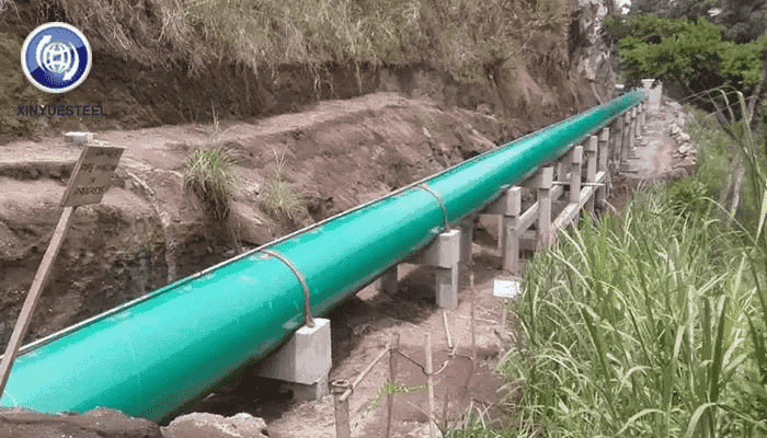

Far too small pressure rating. He needs steel pipe.
Edit: Something like in this picture. My guess is that the picture shows something like a 10 inch pipe with 10 inches of insulating jacket. But it's hard to get accurate size from the picture. Just laying bare pipe on the ground would cause dents and dents become weak points.

Maybe the OP can live with reduced power, then they could locate the turbine higher on the hill, reducing turbine inlet pressure and pipe length.
As interesting as the hydro project is, it will be costly and require work and $$ to maintain.

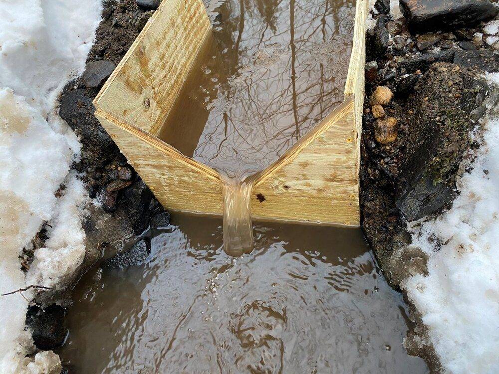

Thanks for the suggestion :) I constructed a couple simple weirs yesterday. I opted for a V-shaped design, since I read that it provides a more accurate flow measurement than other profiles. Here is a pic installed:
Installing the weir was a bit challenging due to the conditions, because the ground is frozen and the only dirt I had available to pack around it was loose rocks and gravel from the streambed. Unfortunately I was not able to stop all the flow from going underneath and around the sides of the weir in my initial attempt. I think I managed to capture somewhere in the range of 50% to 90% of the flow.
I measured the head over the V-notch to be 1.5" and 2" respectively at two different streams, which implies much lower flow rates on the order of 7-13 gpm...less than 10 times what I had estimated before using the velocity method. As a result, I'm now estimating 400 to 800 watts per stream, so that is certainly disappointing, but it's still a decent amount of energy...ie, more energy than consume in our current house on avg. However, it won't be enough to run the proposed heating system (geothermal heat pump) and charge EVs that we need. Fortunately this does not kill the project, because there is a near inifinite supply of water at the bottom of the hill, so it just means that I may need to rely more on using solar power to pump water up to the top into the pipeline in order to maintain higher rates of flow.
As for pipe diameter, it's awesome that head loss is so much lower than I originally thought. Even a 2" pipe would be sufficient for this native flow rate. However, since the plan is to use the hydro for retrieval of pumped storage energy, I really need to size the pipe based on the max power that I would want to deliver. It looks like, if I want my max hydro power to be able to ramp up to about 20 kw, then I should have at least a 8" pipe. I still might want to boost that up to 10" for the extra storage capacity in the pipe, if I cannot get the permit for a dam.
