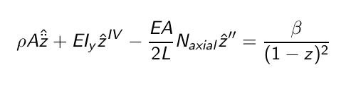

So the problem I have is I want to get the equation of motion of a vibrating beam under a nonlinear "Point" force.
The equation would be like this for a distributed load (Which is not the case)
Equation: rho A z-double-dot-hat + EI_y z-hat^IV - (EA/2L) N_axial z-hat'' = q = beta / (1 - z-hat)^2, with z-hat written as a hat-decorated z.
But I want the load to be at a point at x=L
So I have to options. Add an impulse dirac function multiplied by the beta (Causes numerical errors for my solver), or define the force as follows:
Equation: EI_y z''' - (EA/2L) N_axial z' = F = β / (1 - z)^2, with z hat as the dimensionless deflection variable.
Thus
Equation: rho A z̈ + E I_y z'''' - (EA/2L) N_axial z'' = d/dx F = -2 beta z' / (1 - z)^3, with z as a function of x.
Which one is correct or if both wrong what do I do.
Also even if one of them is correct, any better options? (The above cases messes up my numerical solver)
Note: Obviously, z is a function of (x,t) and also beta is a function of (t)
  • Equation: rho A times the second time derivative of z, plus EI_y times the fourth space derivative of z, minus EA over 2L times N_axial times the second space derivative of z, equals beta over (1 minus z) squared.
How is the beam supported ?
What do you mean by non linear point load ? Has it got any physical interpretation or any defining equation ?
Are you looking for a small deflection or large deflection solution ?
