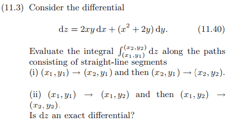

Printed textbook problem 11.3: consider the differential dz = 2xy dx + (x^2 + 2y) dy (11.40); evaluate the line integral from (x1, y1) to (x2, y2) along straight-line segments via (x2, y1) and via (x1, y2), then ask whether dz is exact.

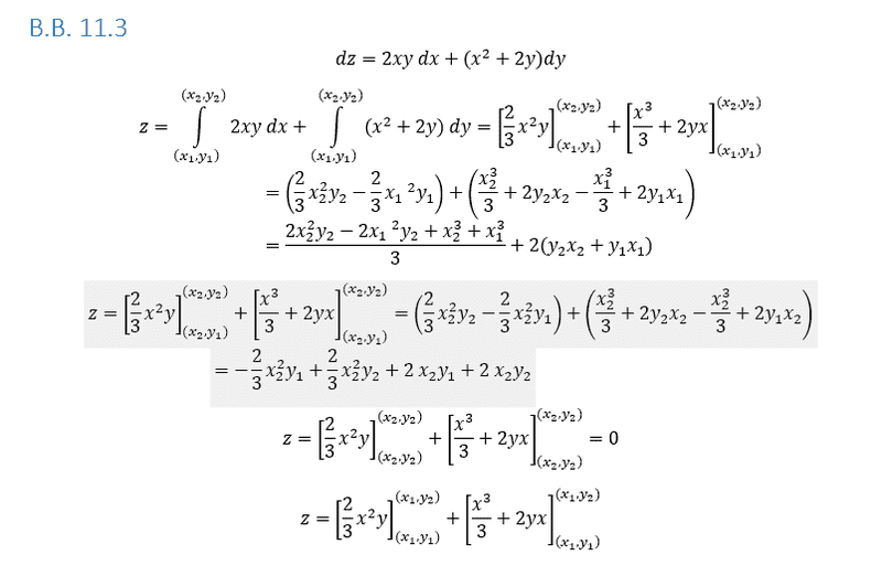

and 3. The Attempt at a Solution [/B]
Handwritten-style math worked solution to B.B. 11.3: line integral of dz = 2xy dx + (x^2 + 2y) dy from (x1,y1) to (x2,y2), with steps evaluated at endpoints, ending with a result z = [2/3 x^2 y] + [x^3/3 + 2yx] evaluated between (x1,y1) and (x1,y2).
The assignment that I'm struggling with can be seen under the heading titled 1. and my attempt at a solution can be seen in 2. and 3.
Obviously, what I'm doing is wrong. I've surely misunderstood the problem statement. Will someone please help me?
Thank you in advance.

There seems to be only two attachments to your post. I think attachment #3 is missing.

There's no third attachment, sorry, English is not my first language.

You seem to be ready to evaluate z between the applicable limits, but you don't appear to show a final result.
Not sure what you doing there, let's take
(I) for the path ##(x_1,y_1)->(x_2,y_1)->(x_2,y_2)## (going through straight line segments) we ll have
##\int\limits_{(x_1,y_1)}^{(x_2,y_2)}2xydx=\int\limits_{(x_1,y_1)}^{(x_2,y_1)}2xydx+\int\limits_{(x_2,y_1)}^{(x_2,y_2)}2xydx=\int\limits_{(x_1,y_1)}^{(x_2,y_1)}2xydx+ 0=(x_2^2-x_1^2)y_1##.
You can work similar for ##\int (x^2+2xy)dy## seeing that it ll be zero for the straight line segment##(x_1,y_1)->(x_2,y_1)## so you need to evaluate it only for the straight line segment ##(x_2,y_1)->(x_2,y_2)##
Then you should calculate same things for the path in (II)
If the answer you get in (I) is different than that in (ii) then we can safely say that it is not an exact differential (why?).
