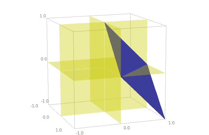

Greetings,
I need to evaluate $$\iint_{S}\mathbf{F}\cdot\mathbf{n}\, dS,$$ where ##S## is the plane surface whose boundary is the triangle with vertices at ##(1,0,0),(0,1,0),(0,0,1)## , ##\mathbf{F}(x,y,z)=(x,y,z)## , ##\mathbf{n}## is the unit normal to ##S## .
There are two representations for the surface:
  • parametric ##\mathbf{r}(u,v)=(u+v,u-v,1-2u) ##
  • explicit ##z=f(x,y) ##
and the general formula for this type of problems is $$\iint_{\mathbf{r}(T)}\mathbf{F}\cdot\mathbf{n}\, dS=\iint_{T}\mathbf{F}[\mathbf{r}(u,v)]\cdot\mathbf{n}\,\left\Vert \frac{\partial\mathbf{r}}{\partial u}\times\frac{\partial\mathbf{r}}{\partial v}\right\Vert \, du\, dv ,$$ but since $$\mathbf{n}=\frac{\partial\mathbf{r}}{\partial u}\times\frac{\partial\mathbf{r}}{\partial v}/\left\Vert \frac{\partial\mathbf{r}}{\partial u}\times\frac{\partial\mathbf{r}}{\partial v}\right\Vert ,$$ it simplifies to $$\iint_{T}\mathbf{F}[\mathbf{r}(u,v)]\cdot\frac{\partial\mathbf{r}}{\partial u}\times\frac{\partial\mathbf{r}}{\partial v}\, du\, dv . $$
Parametric representation:
Given ##\mathbf{r}(u,v)=(u+v,u-v,1-2u) ##, we find $$\iint_{S}\mathbf{F}\cdot\mathbf{n}\, dS=\iint_{T}(u+v,u-v,1-2u)\cdot(-2,-2,-2)\, du\, dv=-2\iint_{T}\, du\, dv. $$ The problem now is that I simply cannot figure out the region of integration ##T## : ##0\leq1-2u\leq1## suggests that ##u\in[0,0.5]## ; taking this into account and the fact that ##0\leq u+v\leq1## , ##v\in[0,0.5]## . But now the two conditions imply that ##-0.5\leq u-v\leq0.5## , while it should be ##0\leq u-v\leq1## .
Explicit representation:
My best guess for the explicit representation of the surface is ##z=-x-y+1## (I omit its derivation here for brevity).
Hence $$\iint_{S}\mathbf{F}\cdot\mathbf{n}\, dS=\iint_{T}(x,y,-x-y+1)\cdot(1,1,1)\, dx\, dy=\iint_{T}\, dx\, dy .$$ Again I have troublems finding the region of integration. If it is the triangle on the ##z=0## plane, then ##x\in[0,1],y=1-x## and we have $$\iint_{T}\, dx\, dy=\int_{0}^{1}\left[\int_{0}^{1-x}dy\right]dx=1/2 ,$$ but the correct answer is “4” (I know it in advance).

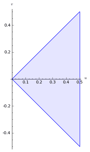

From the first two coordinates in the parametric representation, you have
\begin{align*}
x &= u+v \\
y &= u-v
\end{align*} Try solving for u and v in terms of x and y. You should be able to show that lines of constant u and constant v correspond to lines that make 45 degree angles with the x and y axes. In other words, this transformation is a 45-degree rotation (and some scaling).
The projection of the surface onto the xy-plane is a triangle. Figure out what triangle this corresponds to on the uv-plane. It should be pretty straightforward to figure out the limits from that once you have that picture down.
The problem in finding the ##u,v## limits is to figure out what region in the ##uv## plane corresponds to the triangular domain in the ##xy## plane under your surface. That triangle is bounded by the lines ##x=0,\, y=0,\, x+y=1## in the ##xy## plane. Solving your two equations ##x=u+y,\, y = u-v## for ##x## and ##y## gives$$
u = \frac{x+y} 2,\, v = \frac {y-x} 2$$Use these two equations to find what ##uv## region maps to your ##xy## region. You can use that ##uv## region to get your limits right. Try mapping the corners first. You will need to make some decision on the orientation to get the correct sign.
[Edit]Dang! Vela must type faster than I do.
Vela, LCKurtz,
so I map my xy-triangle onto the uv-plane:
and evaluate the integral accordingly: $$\iint_{S}\mathbf{F}\cdot\mathbf{n}\, dS=-2\iint_{T}\, du\, dv=-2\int_{0}^{0.5}\left[\int_{-u}^{u}dv\right]du=-\frac{1}{2}. $$ However, as you may see I get a negative value. Is this what is meant by "make a decision on the correct orientation"? What does it mean in particular?
Hrm... the book says additionally: "Let ##\mathbf{n}## denote the unit normal to ##S## having a nonnegative ##z##-component", but I cannot see how it can help right now...
So there can be two normals to the surface, each in the opposite direction: $$\mathbf{n}_{1}=\frac{\partial\mathbf{r}}{ \partial u}\times\frac{\partial\mathbf{r}}{\partial v}/\left\Vert \frac{\partial\mathbf{r}}{\partial u}\times\frac{\partial\mathbf{r}}{\partial v}\right\Vert ,\mathbf{n}_{2}=-\mathbf{n}_{1}. $$ Since the area cannot be negative we simply make an arbitrary decision concerning the direction of the normal (take ##\mathbf{n}_2## in this case), is this correct?
Which normal has the non-negative z component?
In our case $$\mathbf{n}=\begin{vmatrix}\boldsymbol{\hat{ \imath}} & \boldsymbol{\hat{\jmath}} & \boldsymbol{\hat{k}}\\ 1 & 1 & -2\\ 1 & -1 & 0
\end{vmatrix}=(-2,-2,-2) , $$ but since its ##z##-component is negative we take ##-\mathbf{n}=(2,2,2)##; is this correct?
Yes, that's correct.
