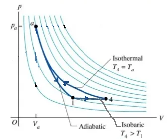

  • #35
Chestermiller said:
I totally disagree with your interpretation and stand by what I said previously. You should know that I have a lot of practical experience with thermodynamics (>60 years), so I am very confident in what I am saying.
In the first scenario, I have calculated the net energy consumption by subtracting the work done by the gas from the energy spent by the piston i.e. (4539.38 - 2240.28) J. And now, as per you, it should be (4539.38 + 2240.28) J, right?

You did say part of your cycle is isobaric when @russ_watters said:
russ_watters said:
Gas in the cylinder starts at atmospheric pressure and room temperature.
1. Gas is adiabatically expanded and cooled. That part you at least made clear.
2. Gas absorbs heat from the room, heating it to room temperature, but remaining a lower pressure.
3. Piston compresses the gas, heating it, while heat is transferred outdoors (outdoors and indoors are at same temperature), keeping the gas at room temp (isothermal compression), and ending up at the state it started in.
Is this your cycle?
The first process is adiabatic;
The second process is isobaric;
The third process is isothermal.
Here is the PV diagram of this cycle:
And you answered in post #34:
T C said:
That's it.
  • #48
The gas will remain in lower pressure doesn't mean that the pressure will remain same during the process, but rather the volume will remain same i.e. it's an isochoric (not isobaric) process. And the third process isn't isothermal as the heat will be transferred to outside after being compressed and not during the compression process.
  • #49
T C said:
In comparison to cooling by compression.
Here's a big surprise: The surroundings doing adiabatic compression work on a gas causes its internal energy and temperature to increase. A gas doing adiabatic expansion work on its surrounding causes its internal energy and temperature to decrease. Isn't that what you are saying?
  • #50
In an isochoric process, the pressure increases, so it doesn't "remain at a lower pressure".
Heat is transferred to the outside in an isothermal compression.
That being said, @russ_watters clearly stated the third process he described was an isothermal compression, and you responded "That's it."
Now you MUST do a PV diagram of your cycle (like I did) for us to follow you. What we got now from you is:
  1. An adiabatic expansion from 300 K to 193 K;
  2. An isochoric heating from 193 K to an unknown pressure (somewhere between states 1 and 2) and temperature (it cannot be 300 K, as the third process isn't isothermal);
  3. A third process, which is a compression that is not isothermal. It seems to be adiabatic from your statement (compression without heat rejection). What are the pressure and temperature at the end of this process?
  4. A possible fourth process that would be needed to reject the heat from the previous compression, possibly isochoric as well?

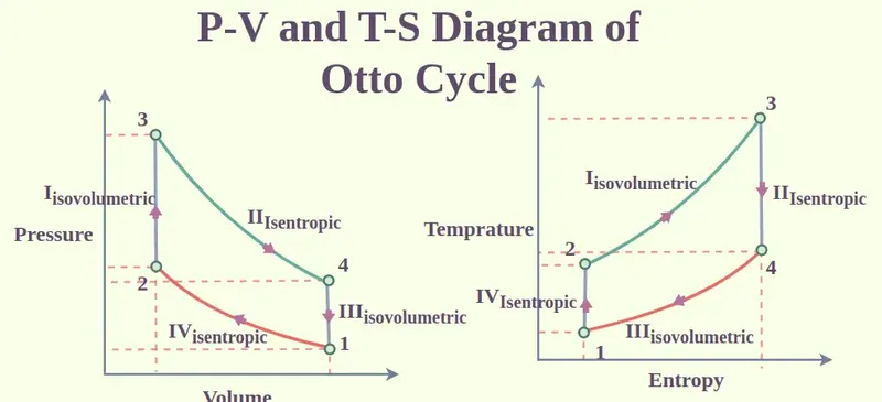

To sum it up (referring to states in the following image): adiabatic expansion (2-1), followed by an isochoric heating (1-4), followed by an adiabatic compression (4-3, ends at very high pressure and temperature), followed by an isochoric cooling (3-2) to go back to a temperature of 300 K. This would be a reverse Otto cycle:
