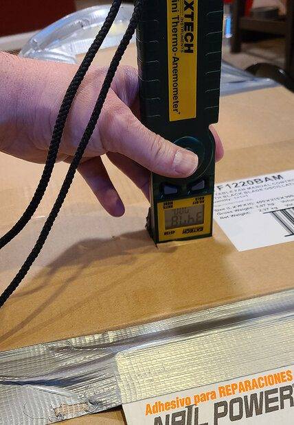

You can use the same anemometer in two different places as long as you don't change the system in between. I was going to suggest on the inlet of the fan. I know that's not as reliable as the outlet, but it would be something. But that doesn't even matter since the fan is stalled and the velocity is lower than the anemometer is capable of measuring. As far as I can tell, the current setup can't be cleaned-up to make it work. He needs to start over from scratch with a bigger fan at least.
That anemometer is large enough (as a fraction of the duct size) that it almost certainly appreciably changes the flow.
  • #50
Agreed. And it could be increasing or decreasing the velocity depending where the fan is on the curve. One of the reasons I suggested a bigger fan is both the anemometer size issue and the gap/re-circulation issue are decreased just by getting a physically larger fan/system (assuming same gap size in cm).

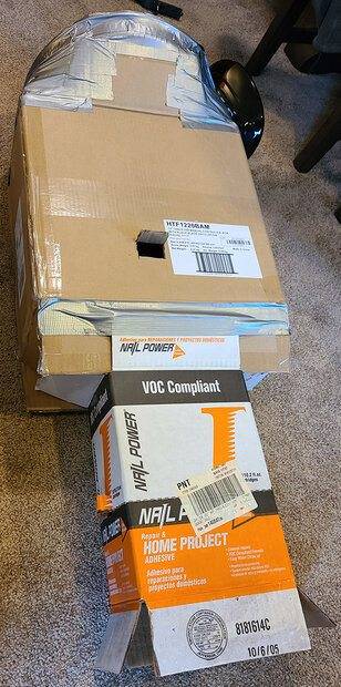

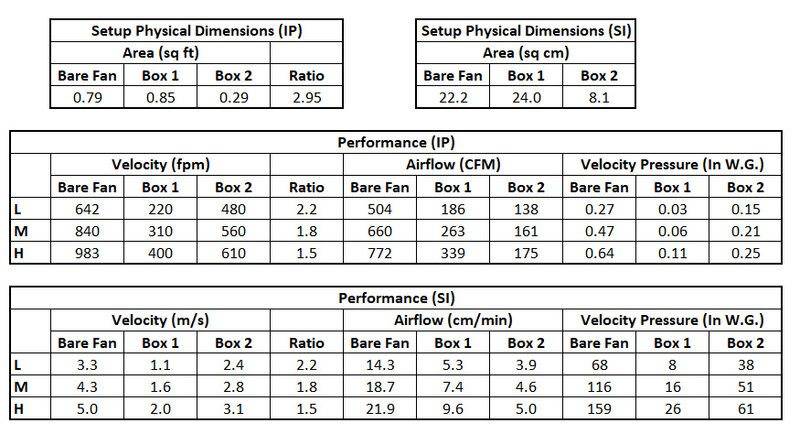

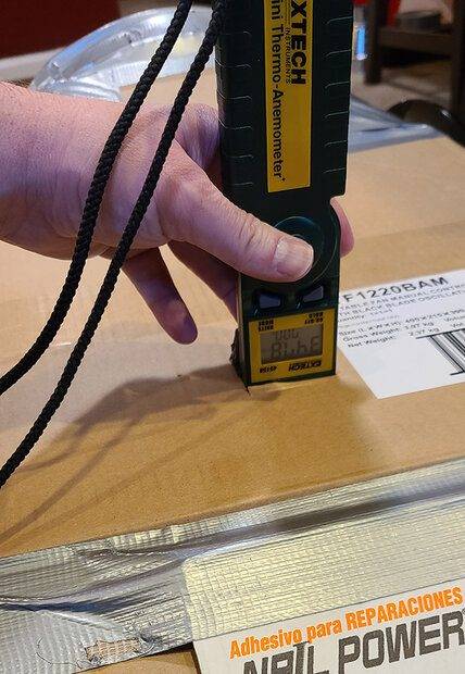

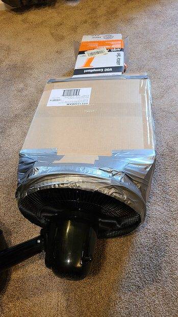

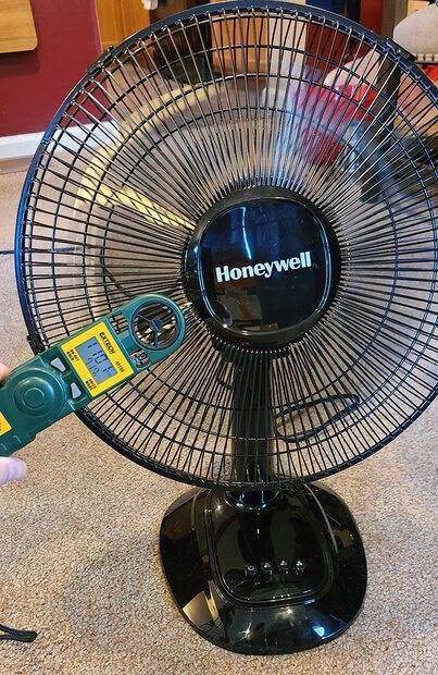

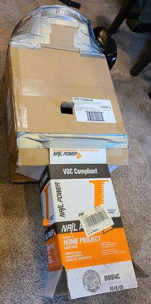

My first attempt at this is shown in the photos below. It went much worse than I expected. Here are the results:
As you can see in the results, the velocity ratio is nowhere close to the area ratio. This is likely due to poorly developed (non-uniform) and swirling flow, caused by the "tube" being installed on the outlet of the fan instead of the inlet (the large central obstruction on the fan is probably part of that). In other words; the measurements are likely unreliable. I'll see if I can re-do the experiment with the fan reversed.
The poor pressure performance and corresponding loss of airflow with the addition of the obstruction was not a surprise. Even with a relatively modest area ratio and associated static pressure requirement, the fan airflow dropped by half and registered essentially no static pressure (0.02" or 5 Pa) in the big box.
Below is a video I uploaded to Youtube showing the performance change as the variable geometry outlet nozzle is actuated closed. Note, the fan shutoff pressure is 0.07" (17 Pa) and the the fan audibly slows due to the added resistance. By comparison, here's a random residential toilet exhaust fan that's a centrifugal blower, which can achieve around 0.6" shutoff pressure (the curve is cropped at the top though):

Early returns on the draw-through design are promising, with results within about 10% of predicted. Details tomorrow.
  • #56
Draw through is almost certainly the way to go. It basically eliminates swirl and also gives much more consistent flow across the cross section, especially if you use a flow straightener on the inlet - a cheap and easy way to do this that I've seen used on homemade wind tunnels before is actually to just buy several large containers of drinking straws and cut them (the entire container, straws and all) to a length of a few inches and fill the inlet with these. You'll also get much better results if you have a diffuser on the exit for pressure recovery - this will greatly reduce the static pressure requirement on your fan, and allow it to operate much closer to its open air performance.
