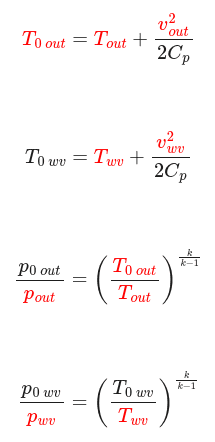

I will attempt my solution to the problem. As I mentioned previously in post #29, I would consider this as a fluid dynamic problem for compressible flow and use conservation of mass, energy, and momentum. I would consider a three-pipe branch pipe junction, consisting of the venturi throat inlet and outlet, and the pipe coming from the reservoir. For the conservation of momentum, the angle between the pipes should matter, but I'll keep it simple. I will also not consider condensation within the venturi nozzle (RH always below 100%).
For the following, subscripts represent the conditions at the following locations:
##in## : throat inlet
##out## : throat outlet
##wv## : water vapor pipe
Conservation of mass
$$\dot{m}_{in}+\dot{m}_{wv}=\dot{m}_{out}$$
$$\rho_{in}v_{in}A_{in}+\rho_{wv}\color{red}{v_{wv}}A_{wv}=\rho_{out}\color{red}{v_{out}}A_{out}$$
Where:
##\dot{m}##: mass flow rate
##\rho##: fluid density
##v##: fluid velocity
##A##: cross-sectional area of pipe (##A_{in}=A_{out}##)
Conservation of energy
$$\dot{m}_{in}h_{in}+\dot{m}_{wv}\Delta H_{vap}=\dot{m}_{out}h_{out}$$
$$\rho_{in}v_{in}A_{in}\left(T_{in} + \frac{v^2_{in}}{2C_p}\right)+\rho_{wv}\color{red}{v_{wv}}A_{wv}\Delta H_{vap}=\rho_{out}\color{red}{v_{out}}A_{out}\left(\color{red}{T_{out}} + \frac{\color{red}{v^2_{out}}}{2C_p}\right)$$
Where:
##T##: temperature
##C_p##: specific heat capacity
##\Delta H_{vap}##: enthalpy of vaporization (value for given water temperature)
Conservation of momentum
$$p_{in}A_{in} + \dot{m}_{in}v_{in} + p_{wv}A_{wv} + \dot{m}_{wv}v_{wv}=p_{out}A_{out} + \dot{m}_{out}v_{out}$$
$$p_{in}A_{in} + \rho_{in}v^2_{in}A_{in} + \color{red}{p_{wv}}A_{wv} + \rho_{wv}\color{red}{v^2_{wv}}A_{wv} = \color{red}{p_{out}}A_{out} + \rho_{out}\color{red}{v^2_{out}}A_{out}$$
Where:
##p##: pressure
Stagnation conditions
$$\color{red}{T_{0\ out}} = \color{red}{T_{out}} + \frac{\color{red}{v^2_{out}}}{2C_p}$$
$$T_{0\ wv} = \color{red}{T_{wv}} + \frac{\color{red}{v^2_{wv}}}{2C_p}$$
$$\frac{p_{0\ out}}{\color{red}{p_{out}}} = \left(\frac{\color{red}{T_{0\ out}}}{\color{red}{T_{out}}}\right)^{\frac{k}{k-1}}$$
$$\frac{p_{0\ wv}}{\color{red}{p_{wv}}} = \left(\frac{T_{0\ wv}}{\color{red}{T_{wv}}}\right)^{\frac{k}{k-1}}$$
Where:
##T_0##: stagnation temperature
##p_0##: stagnation pressure
##k##: ratio of specific heats
We get seven unknowns (in red) with seven equations to solve (densities can be found with pressures and temperatures). And then the flow out of the throat get into the divergent section where we can get the final values to determine what temperature we get. Again, there would be the Mach numbers to watch out for as well.
I really don't know how to give a simple answer without solving the system of equations with actual numbers given. Throwing the possibility of condensation in the mix complicates the system even further.

  • #51
The LaTeX for the color rendering didn't work for me the \colorred command appears inline. Very hard to read.
  • #52
Now its better! Magic

Your problem now is that the total temperature can be split into 2 components:
$$T_{0\ out} = T_{out} + \frac{v^2_{out}}{2C_p}$$
You say "I'm sure ##T_{out}## will increase". Well, maybe not. The fluid might come out at a faster speed instead. Or it could be a mix of both.
