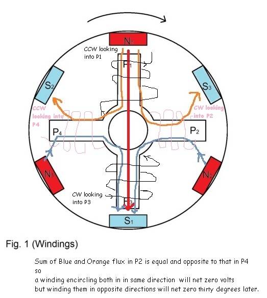

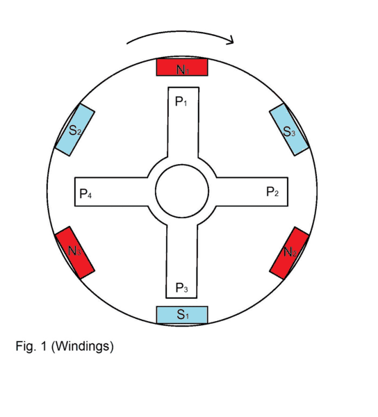

I attach an image of something I am experimenting with.
The picture itself (and added text) should be self-explanatory.
1) Which way should my windings (clockwise or counter-clockwise) go around P1; P2; P3 & P4 for maximum voltage (V) ?
[ 1 Ø ]
[ 1 x single enamelled copper conductor ]
[ 2.5mm² ]
[ 65 turns per P1 - P4 each ]
[rotational speed = 9 revs/sec]
2) Is there a method of calculating Vmax & I max outputs from the above ?

Is it supposed to be a two phase alternator? Will you rectify the AC from the windings to produce DC?
If so, the gaps between the poles are much wider than sensible. Better utilisation of materials if closer together.
The coils should be on the stator, not the rotor. The coils will tend to be thrown off that rotor, so better to have a magnet that rotates with stationary windings and no slip rings.
At low RPM you will need many more poles. Fisher & Paykel smartdrive washing machines have 48 poles.

So back to my question :
Vmax will be dependent on the number of turns per pole, the spacing and dimensions of the poles, the strength of the magnets and the specified RPM.

A 6-pole rotor and a 4-pole stator.
jim hardy said:
Six pole stator, four pole rotor... sounds more like a stepper motor than a generator.
What does right hand rule tell you ?
Jim, the rotor is the outer part. [6-pole rotor & 4 pole stator.]
The 6 x neodymium magnets are fixed to the inside of a cylinder which rotates (9 rev/s or 540 rev/m) around the 4-pole stator which is fixed on a shaft.
OPTION A
The idea is to get the maximum voltage and current (within limitations) from this configuration (preferably single phase).
At this stage my stator is wound CCW-CW-CCW-CW and I get between 10Vrms & 15Vrms from the output - but the moment I put a load (10V globe) the output halves. I suspect that the windings at present is wrong and that a configuration of CW-CW-CCW-CCW would be more suited.

Then wind it as a two phase alternator, with (P1+P3) and (P2+P4).
Rectify each phase independently with a bridge rectifier, sum the DC outputs by connecting the DC outputs in parallel.
The DC output voltage will not fall to zero like a rectified single phase alternator.

How are you viewing the coils and how are they connected together? Can you mark up the drawing?

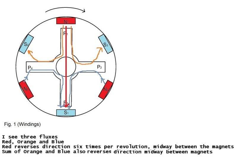

Here's the thought line i was playing with
There will be leakage flux through tips of P2 & P4 , between adjacent magnets, that i didnt draw because it won't couple your windings.
so it seems there's likelihood it'd work as pair of two pole rotors.
Connect opposing poles in series , wound same direction. Note a single winding is CW looking into one end, CCW looking into the other.
Energy conversion will flip-flop between even and odd poles.
I think that's what you have .I'd sure like to see the waveform that thing makes. Have you an oscilloscope?

This was a good proposal and indeed this is what I will do. After measurement etc. I will post the results.
I will take a picture of my oscilloscope waveform (I am just as curious to see the wave form) and submit.
