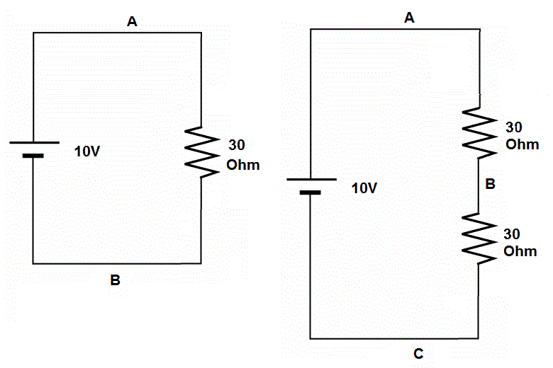

Jacob Gawel
Assuming the resistance of a wire in a series circuit, consisting only of 1 component (e.g. filament lamp) and a battery, is negligible; does each Coulomb of charge commit all of its electrical potential energy, supplied by the battery's potential difference, as work done across the component (thus electrical potential energy gained at battery = electrical potential energy lost across component)?
If so, how is voltage divided evenly across 2 identical components in series?
i.e. how do the circuit electrons give up only half their electrical potential energy at component 1, to 'save' some electrical potential energy for component 2?
lets look at a couple of examples
The left hand part just shows a single resistor across the 10V power supply
Using Ohms Law, we can work out the total current flowing in the circuit
I = V / R ( Current = Voltage / Resistance)
I = 10V / 30 Ohms
I = 0.33 Amps
in the second circuit if we want to find the voltage drop across each resistor
We first do that same step again work out the total current flowing in the circuit
I = V / R
I = 10V / 60 Ohms ( 30 Ohms + 30 Ohms)
I = 0.166
Now that we know the total current flowing, we can now use Ohms Law rearranged to find the voltage drop across each resistor
NOTE ... because the resistors are the same value, the voltage drop will be the same across each of them ... therefor we only need to work out the voltage drop across one of the resistors
V = I x R
V = 0.166 x 30
V = 4.98V
Close enough to 5V drop across each resistor
Now you could do an example where the two resistors are different values and work out the voltage drop across
each resistor.
NOTE .. the addition of the 2 voltage drops will always equal the total voltage across the circuit.Dave
